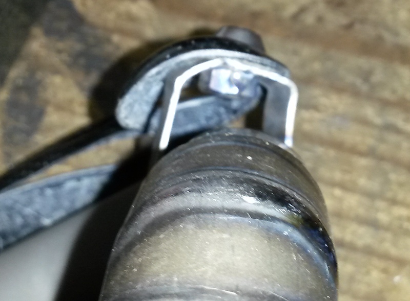

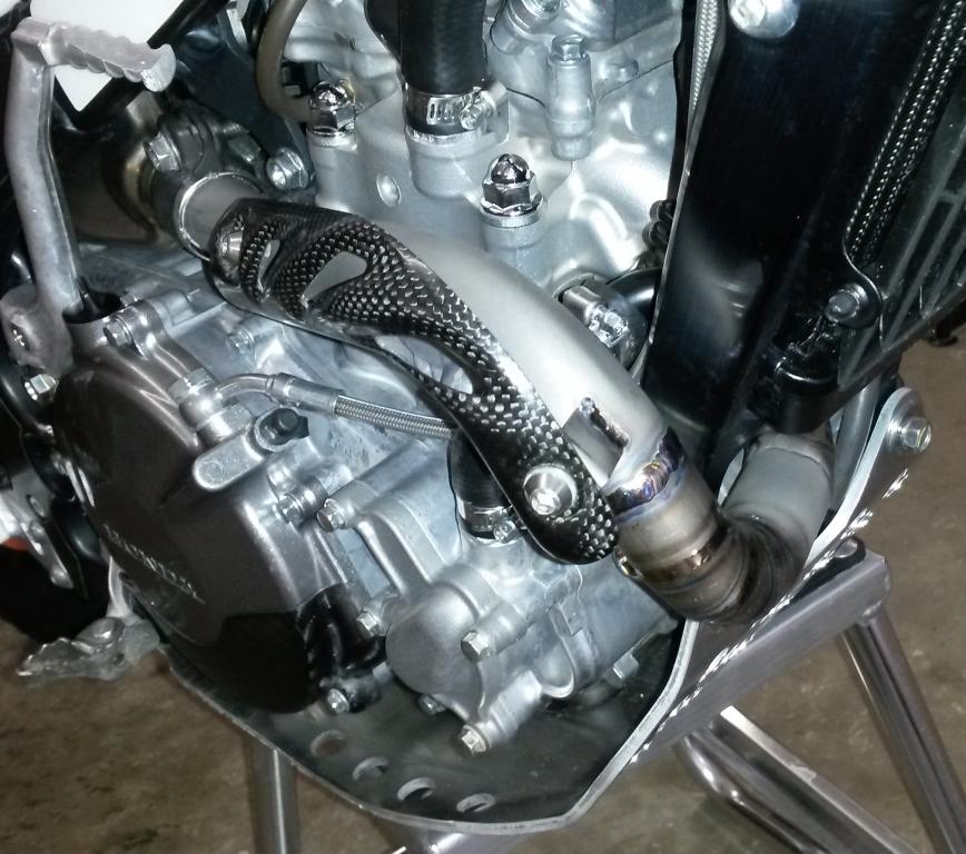

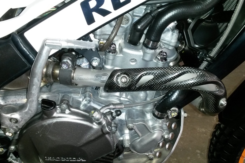

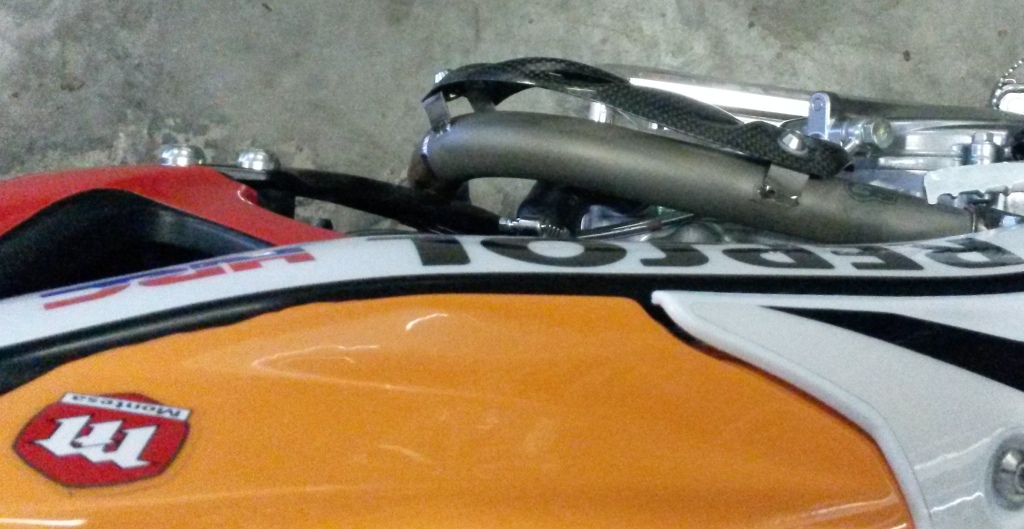

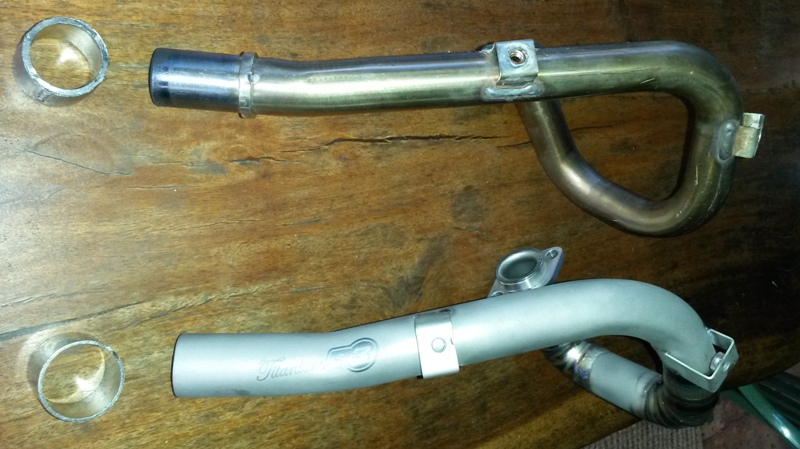

Just by way of an update...
I bought the S3 pipe. Overall I'm pretty happy with it. It fits perfectly and is very compact and tight into the bike. And it weighs 158 grams less than the original pipe and seal.
The big problem for me is the mountings for the heat shield. The hole spacing is perfect but the mounts are too big and too far off the pipe. As you can see in the photos, the mounts are rectangular instead of square and the rounded shape of the heat shield won't sit down on them. I had to bend the front one to get it to fit but that exacerbated the second problem in that the mounts are too high (to far off the pipe) meaning the heat shield hangs out to the right more than it should. That's a pity because the pipe itself is so compact. S3 could have saved precious titanium and weight by making the mounts the same as stock.
Performance wise, the bike does feel smoother (and slightly quieter for some reason). But no more power.
At 28mm OD, the S3 pipe is 3mm bigger than stock and looks right on the bike (other than the heat shield problem).
The solution could be to take it to a welder and let it replace the bracket, but not really what you want when you buy a new part. I would contact estres with the pictures, they could learn something from it, and they might have advise or a future discount or something for you :P
Only adapting the product yourself makes it difficult to send it back.
It does look sweeet.
Edited by crazybond700

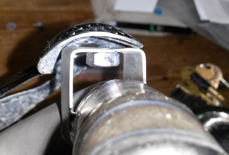

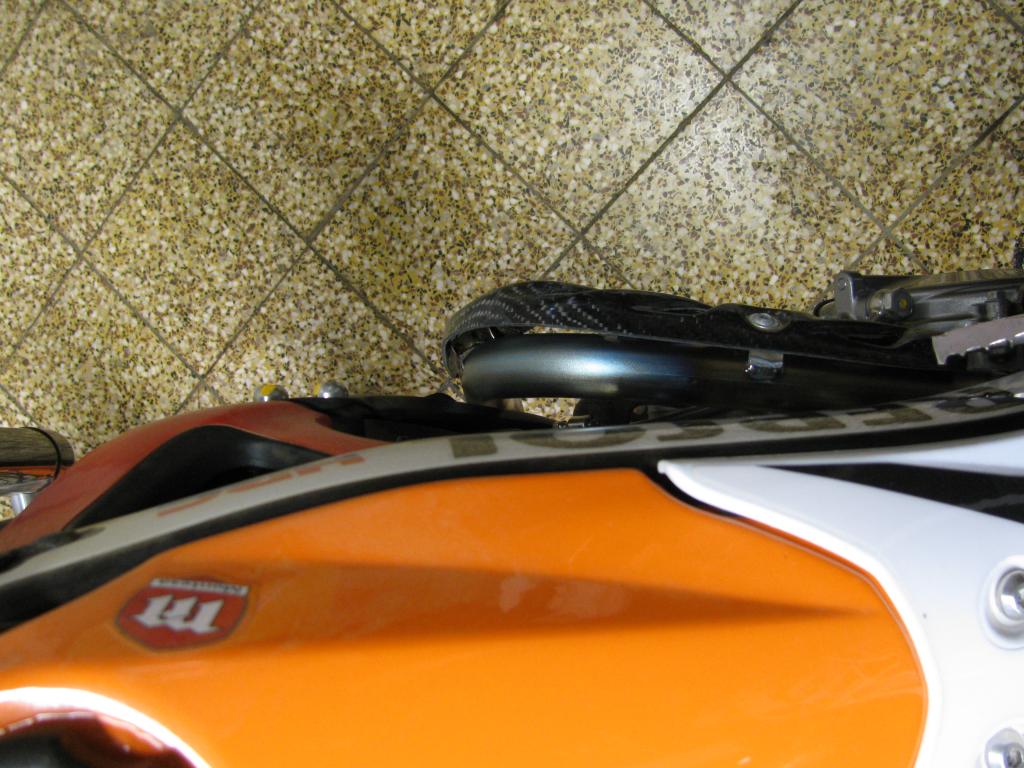

The shield on my Mitani titanium pipe has the same problem, it stands to far of the pipe
Thanks Guys, for taking the trouble to show your Mitani pipe. Don't feel too bad - mine is a lot worse.
I can TIG weld ok, so I need to visit the local welding shop to see if I can buy a single stick of titanium TIG wire and I'll fix it. But right now I don't feel like taking the pipe off again. Such a pity S3 couldn't be bothered to check their products a bit more closely. The pipe itself fits great.
Do you have the full mitani system? Do you have a pic of how the rear and front join? The standard pipe to the mitani rear doesn't slot over as far as the standard set up. Also what size mitani pipe is that? A 26mm or 27mm, do you know what the difference is between buying either? Regards

Yes, I have a full Mitani system.
On my previous 2008 4RT I had a 25.4mm Mitani front pipe which fitted perfectly in the Mitani rear exhaust. I sold this bike last year so can't take a picture of the joint.
On my 2015 4RT I mounted the rear Mitani exhaust of my previous bike and I bought a 27mm Mitani front pipe. Because the connection part of the rear exhaust also has a 27mm outer diameter, I made a stainless steel split sleeve that goes over both pipes, which is held in place with a stainless steel exhaust clamp.
I was assured by Josep Banyeres that a 26mm is more than enough for a 4RT, even with a 280cc kit, but I bought the 27mm because of the matching outer diameters.
But I'm not sure that a 26mm front pipe will fit in the Mitani rear exhaust because that is made for the standard 25.4mm front pipe. I can't say this for sure though because it might have a reduced diameter at the joining part..
