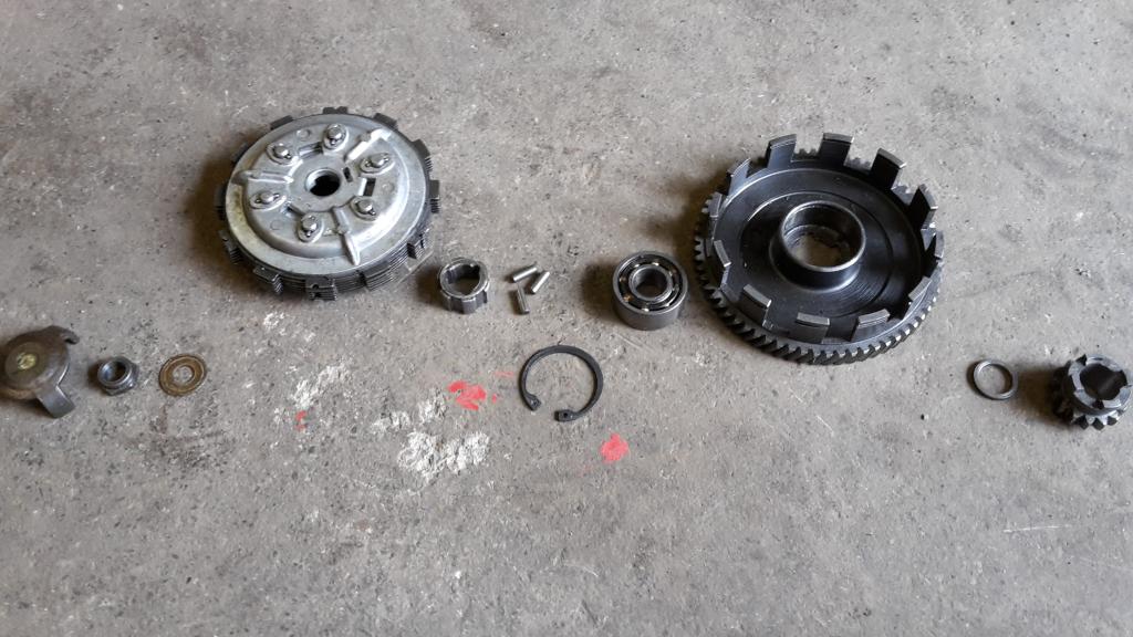

post-11536-0-11870700-1436363053_thumb.jpgthis is what you should have mark i removed bearing and no shims ,, i have never fitted shims on input shaft right side it could be possible the spacer 2nd part from right comes in differnt thicknesses
