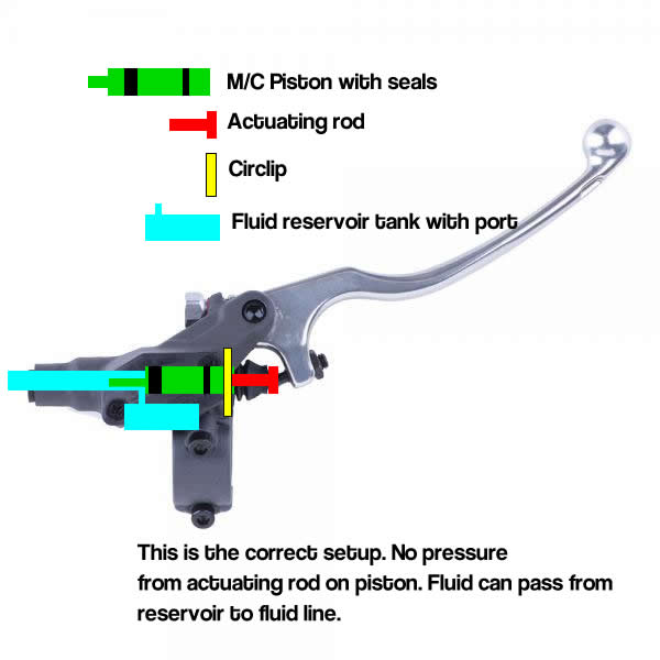

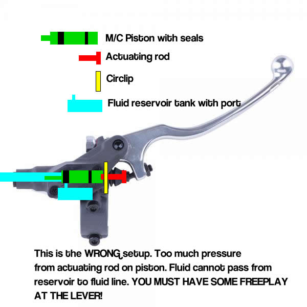

 Sounds like you did not leave enough play in the lever. Started locking up because it could not return fluid to the reservoir.
Probably no freeplay at the lever.
If you are applying any pressure at all on the piston with the lever actuating rod, then you have probably have blocked the transfer port from piston to reservoir and will never be able to bleed it.
YOU MUST HAVE SOME FREE PLAY AT THE LEVER.
check out this link for an explanation of the piston position:
https://thehellteam.wordpress.com/2015/07/10/trial-master-cylinder-and-lever-setup/
Edited by arnoux

 If you have plenty of free play, there are two things that you might not see. You can have the front lever bolt actually tightening while pulling the lever. Also have you pulled apart the master cylinder and verified the little port is not plugged to the reservoir? Also the piston can bind, but just slowly returns to the off position.
