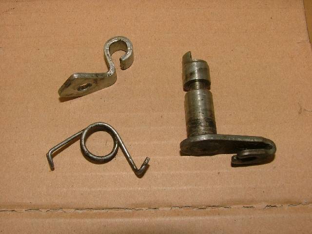

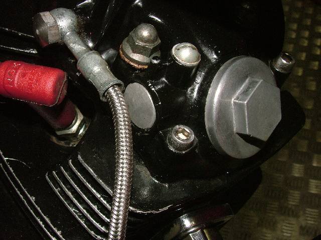

I am trying to fit a valve lifter to my 250 TLR. where the lifter goes there is a metal plug, what i need to know is once the plug is removed what does the lifter fit into, a bearing? and is there any sort of oil seal fitted ?. Any help appreciated.
Does your cyl head not/never had a lifter fitted? I will have a look at mine tomorrow.

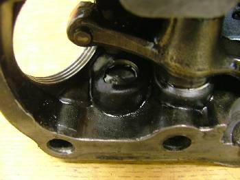

I cant tell from memory if thats a complete rtl motor? how does the metal plug fit on? My rtl certainly isnt fitted with decompressor. i would need to have a look at it and compare to superhondamans photo.

Hi dude. Looks like you need to drill and tap that plug, pop in some all thread with a nut and washer other end to plug and gently tap against the washer till the plug comes out. It looks to me like its press fitted into the standard seal for the lifter.Cheers andy..
Yes that worked,did on wed eve but used a socket & tightened it down and it gently pulled the plug out. Orderd a seal, Honda part since they are Honda size only and not available off the shelf, just waiting on that to then put it together and get to use the old beast again.
