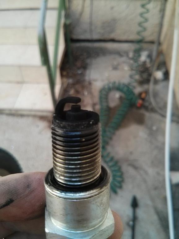

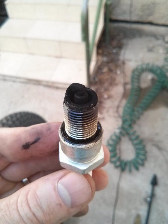

September 2, 201511 yr Author i use silkoline (before that motul) 100% synthetic, gap is set to 6 mm, i also tried the iridium plug and it got fouled as well i have some suspicion that on high RPM i don't get a good spark, usually the engine dies after some time in low RPM - when i want to rev it to clime a hill or a step it bugs and stall. if i am able to start it it back fires and will hardly go up the RPM, sometimes i manage to rev i and clean the plug, sometimes it just stalls and i need to replace the plug ' attaching some pics of the plug

October 12, 201511 yr Author hi thanks for the reply. i switched to main 105 and idle 34 (with the needle in the lowest position), the plug came out clean after a days ride - and that means i am close to the spot. all other items were checked (exhaust, air filter, reeds etc) - and the bike feels strong and responsive so i hope this saga is over for me thanks
