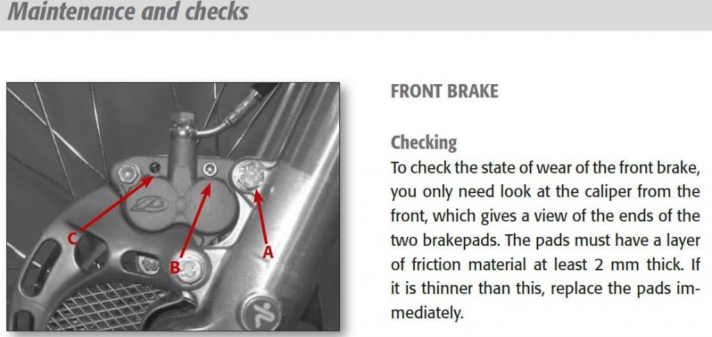

September 6, 201510 yr straight from the user manual...min thickness for pads is 2mm. replace earlier to avoid what you've described. they don't wear symmetrically because they have a leading and trailing edge....once worn this causes the pistons to thrust and they get stuck...a tiny piece of grit inside will make this a whole lot worse....these calipers only have primary hydraulic seals...no dust seal..they need frequent cleaning Edited September 6, 201510 yr by worldtrialchamp
