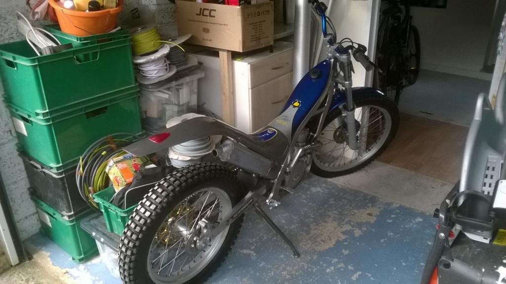

Hello chaps,
I have bought my first bike, a 2000 290.
1) I have a crack on one of the welds by a foot pedal, is this fixable?
2) How do I mix fuel, I've heard is 80/1, how do I physically measure that out?
3) I have put it into gear and i'm too frightened to start it, how do I find neutral?
1.) probably yes let's see a picture.
2.) get a ratio right mixing cup or use 1.5 oz of oil per gallon.
3.) press the shifter all the way down then click it up to find N. Or just start it with clutch in.

Id say not, he says its his first bike.
1.Fixable most definitely, although with a chrome frame id rather have it tig'd or mig'd rather than welded with gas. Gas will burn more of your chrome.
2. As above 5000ml/80 is 62ml. Gonna need a measuring cylinder of some kind
3. You may need to rock the bike back and forward a little when trying to find neutral. With a bike the age of yours id advise against starting in gear using the clutch, your clutch will most likely drag when cold. First time you put it into gear with the engine going be ready for it to jump a little!!

Find a local welder with TIG. Best to grind off the chrome in the area. Tell him it is 4130 material. Nothing too special here. Prolly a tenner to fix. Silver paint toutch up.
The clutches often stick solid after sitting due to oil stiction. Find neutral by rocking as stated . All the way down then one click up.
Freeing up a stuck clutch prior to starting is ALLWAYS best!!! To do this place your butt(weight) on the bike and rock the bike as in before, clicking up to 5th gear with hand.
Pull in clutch and rock the bike heavily fore and aft until you feel the clutches break loose and allow the bike to roll, then roll it a bit.
Go back to neutral, start motor. Still be carefull and pointed in good direction prior to placing into gear.
This is an ALLWAYS procedure! Trust me!

Thankyou for all your replies.
Glad the foot rest can be welded, it looks ok but i'll take it somewhere :)
62mls, I notice the green tanks are 5l so i'll fill one up then use a measuring cup with 62ml of 2t oil then. Do I stir it? lol
I noticed when the guy first let the clutch out it lurched forward a bit and he said they were like that when cold. I'll try the techniques you guys say to find neutral - eek!
I figured it would take off hehe. Love all your original stickers, that bike is mint! I'll try to get it in neutral over the weekend and also get some fuel in it.on inspection it seems to have been welded before as there is spray paint over the pedal.
Thank you everyone, got it out of gear by rocking it. Woohoo!
