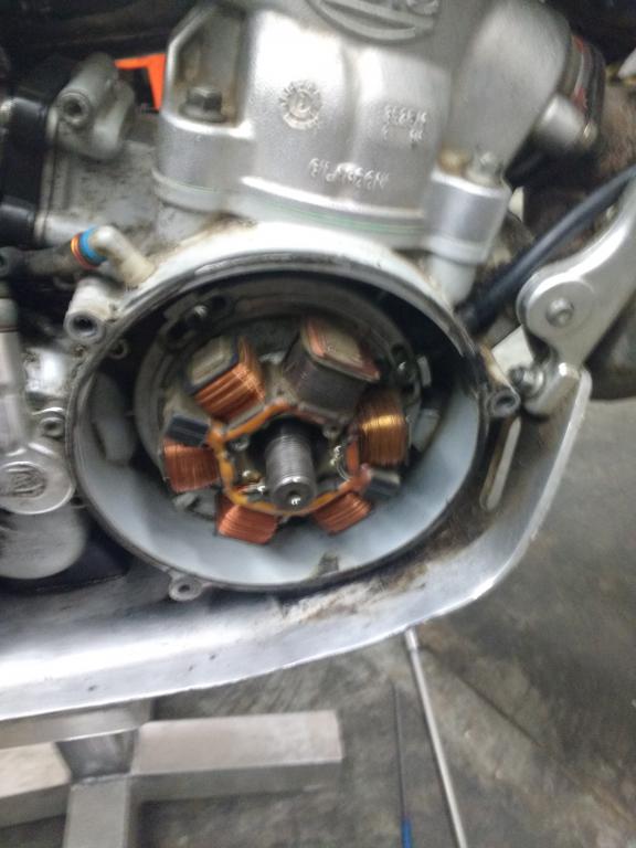

October 3, 201511 yr Author So here's the stator, seems OK I think. Not sure about the copper plate on the coil top right in the pic though. It looks like its been rubbing.
October 3, 201511 yr Author So I'm thinking it needs a stator. I'll check the resistance. Sparks ok with a plug against the head, but when hooked up to a spark tester it was very weak. Anyone reading these ramblings have any thoughts?
October 5, 201511 yr Author Clened up the stator coils and magneto. Ran a new ground to motor mounts from cdi. Starts second kick cold.
