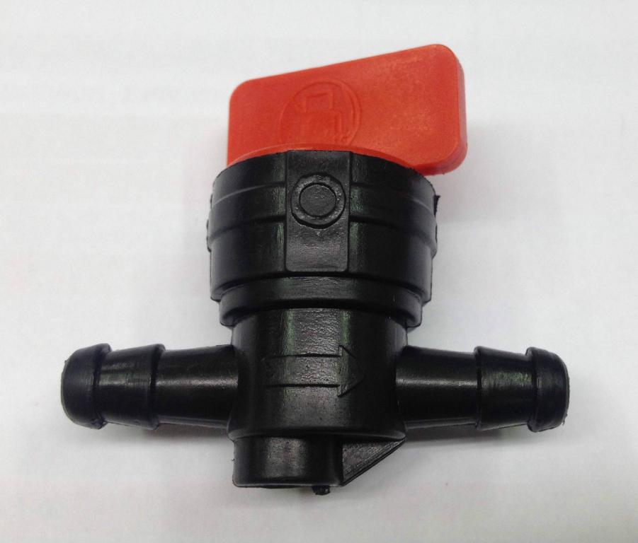

Had same issues on both beta 50 and 80. I managed to get the original tap fully open and then fitted one of these in the line. Leaving the original beta one in the always open position.
http://www.ebay.co.uk/itm/INLINE-PETROL-FUEL-TAP-FITS-BRIGGS-STRATTON-HONDA-ETC-WP43502-/161872906731?hash=item25b06089eb:g:DGEAAOSwT5tWMd-x
These are easy for the kids to turn and you can see straight away if the fuel in on or off.
Cheers.
Thanks I might do the same although still be wary that the original tap might still stop the fuel....
