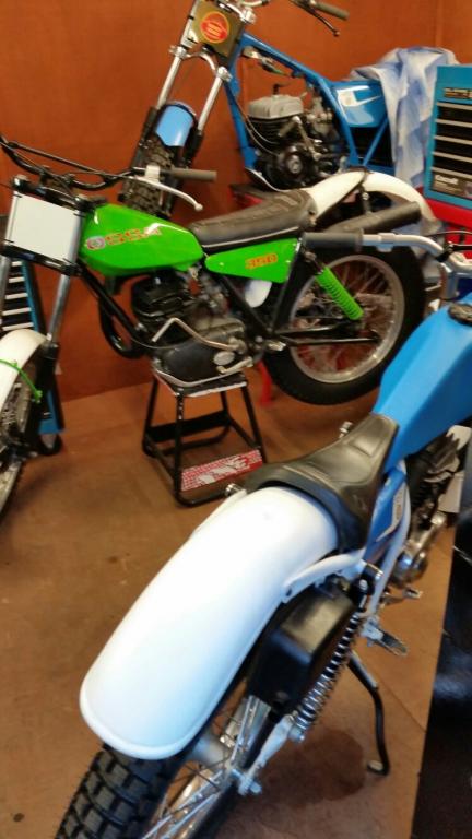

Ossa Tr77
My TR77 came with a Motoplat electronic ignition which needed repair so got replaced with the new system.
Ride height is little changed from the MAR which had the upper shock mount at the point where the two frame tubes meet with the lower mounting forward of the rear wheel slot, the 77 has the lower point much further to the rear and the upper mount opposite the top side cover screw so overall there is little difference other than a change to the operating angle of the shock, it is worth remembering that the 77 was forerunner to the Gripper which had angled shocks mounted on raised brackets to bring the shocks within the frame.
The forks which I think are about 31" if set with an 1" or more through the top yoke are again then not too different from the earlier bikes whose fork length was +29"? or more from spindle centre to top of leg.
The TR77 came at a time when suspension developement was taking place in all forms of off road sport,the Comerford Bultaco ridden by Vesty being just one and similar design changes taking place at Montesa, they were all looking to improve the rear suspension so the 77 has to be taken in the context of its time, they are a good bike with strong back up from Marlimar.
