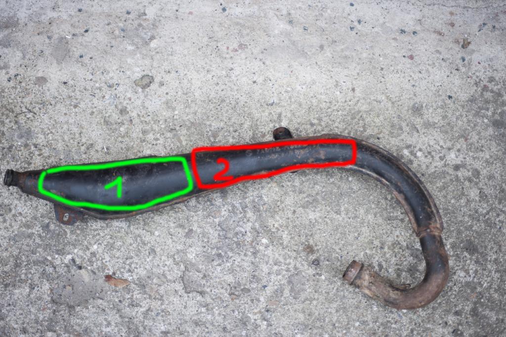

hi, can somebody help my ? i like to repack my exhaust on fantic trial 200. where to cut it ? 1 or 2 ?

sorry can't help you with pictures, but i can tell you that i never cut the pipes of my Fantics, i only use a blowtorch and the pipe became clean and the engine run well
I cut mine open a few years ago and I cut half of 1 and half of 2 and it worked great!

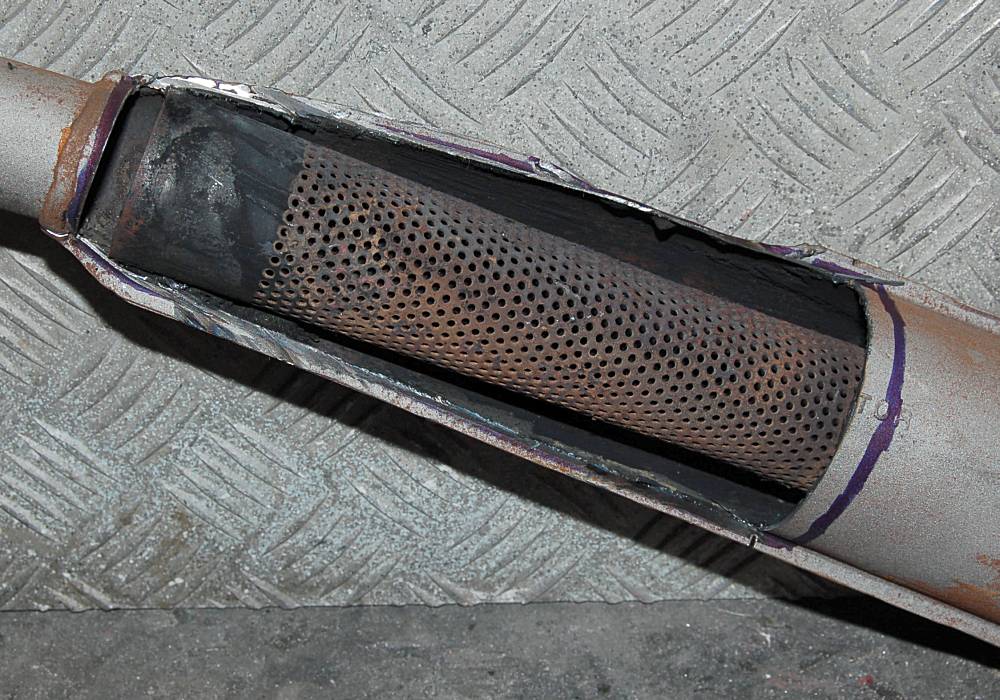

ok, found these
is the pipe "factory" empty or filled with "wool" ?

Cut at circle 1 as it hides behind air box after it's been welded back, there will be a sort of packing in there, but I ran my without after burning it all out, no problems.
I ride a 240 and have a few expansion chambers , 1st one when I got the bike , got the serious Cleaning/soak in solvent and the the torch treatment .And then a blowgun to get all the debris out , rinse & repeat ...2nd one got cut open to see what was inside , similar to the photo , repacked and welded back up ....NOT worth the effort .! My bike runs better with the burned out unrepacked pipe than with the repacked pipe . Sounds just a tick more ringdingy, but make sure you've got a good clean silencer on it and it will respond better at all rpm's. And the pipes are about irreplaceable, so why risk damaging one  ????
