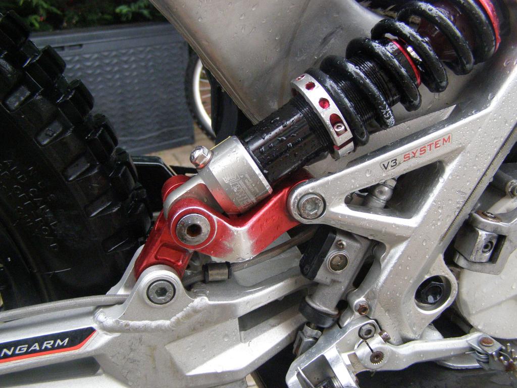

Its a raining day , so the picture is not very clear , but I hope it will help you . I am 95 Kg ( without breakfast ... ) so I needed to preload the spring to set the sag . Where exactly is your problem ? post-18116-0-46815100-1452419399_thumb.jpg

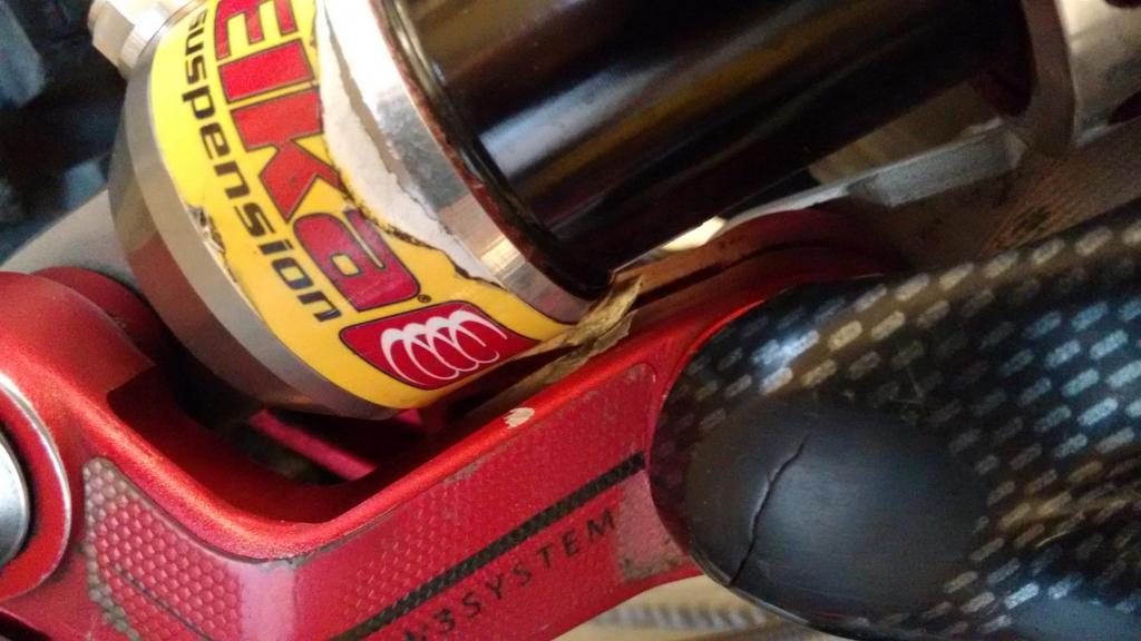

Ouch - looks like I better get the trigonometry calculator out - is it "bottoming out"? most probably not the shock damper itself but is it the rate of compression and spring loading or does the V-link go over centre and cause the clunk of the larger base on the Elka shock on certain types of landing. Yes, I know, I should ride better off rock ledges to avoid the clunk - but I am not perfect all of the time :D. Maybe I need to tighten up the spring and adjust the damping (as previous I am 71-74kg). Any one give some any guidance on what sag they have set for their shock and/or what setting (clicks from fully anti-clockwise) of damping might be interesting to share. Here are two pics of the current V-link. I can see that as it came from the factory it was already milled out to accommodate the larger diameter of the Elka shock (which looks different than sliks and then a dremel has removed more material but looking closely the outside link is the one that has a contact point on it, so it still clunks. I never had to touch the Olle shock on my 2014 Jotagas 250 - so now needing to think more. I am happy to work through a solution where it is possible.

Remove the spring from the shock then move the wheel up and down so you can see what's happening.It doesn't appear to be touching much,maybe 0.5mm off the linkage and a small chamfer on the shock would do it

Apparently, the Elka shock on my bike always clunked on landing from new (as per previous owner who did slightly dremel the connect point on the V-linkage). I have since last written wound up my spring compared with previous owner and measured sag (but always on the lower end of settings as I like a softer cushioning setting), played around with the damping setting and dremeled out some of the linkage and chamfered the edge of the shock bottom (silver bit) more than what was previous. I have got rid of the clunk and have a nice progressive softish setting that suits me. I had the advantage for a while of having my 2014 and 2015 bike together so could replicate the feel that I had liked on the 2014 bike. I am pretty sure that bearings were all okay and had replaced one of the ones on the V-linkage due to my error in inserting and tightening the bolt (pushed out one of the loose rollers against the bearing cage and made a dent in the cage.
