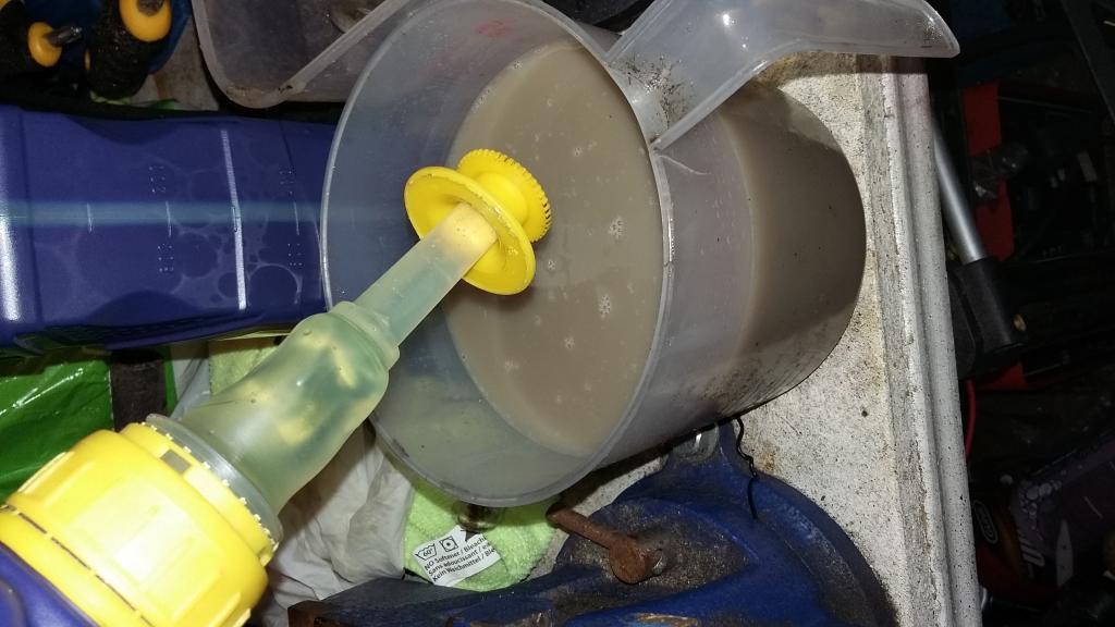

I've just bought a 2006 Rev 3 200cc.
It starts and runs delightfully, but going through the usual fluid changes before taking it out the gearbox oil clearly had a lot of water in it.
I took off the water pump housing and impeller and it all looks stunningly nice and new. Having looked at a few more posts on similar topics the consensus seemed to be to change the oil, run it for a bit and then see what happens.
So I changed the oil and had a play about for about two hours yesterday.
I was a bit hamfisted filling it, so actually put in 700ccs of Putoline light gearbox oil, but when I dropped it out today I got 800ccs of nasty wet stuff. See pictures, The oil bottle's just there for comparison.
To add to the confusion I went to top up the coolant and see how much was missing and couldn't get more than a drop into it.
My reflex thought would be the water pump seal, but then I should be loosing water from the cooling circuit.
Could that much have remained in the gearbox? It was warm when I drained it.
I'd be most grateful for any bright ideas.
Many thanks
gear oil contaminated with water/coolant will coagulate and the clumps tend to deposit in the upper reaches of the gearbox cavity making it awkard to flush. I've had to use other fluids in the box to completely fill it and slosh it around, drain it, filter the fluid, repeat process again. ...it takes very little water to change the appearance of the oil...also gets in through the gearbox breather hose

Got your seal in backwards...
That's the one! Take the casing off and fit a new seal with the sealing lip towards the water side, also check the shaft to make sure that it isn't grooved and check the 2 small bearings while your in there.

Thanks Chaps,
That's great news. I've got the clutch out at the moment anyway (doing the mods) so I'll dig a bit deeper and sort that out as well.

Give it a good flush out in there, my bike came with a knackered seal and it's only running clear now...5 flushes later!
Maybe worth doing a few flushes first with cheap thinner oil before using the good stuff?

Nothing wrong with "light gear oil", it's recommended by Beta, Montesa and GasGas.
But use the same oil for flushing as you're going to use for riding.

         Thanks for the help and advice. I replaced the water pump seal (the shaft was fine) and then flushed the gearbox first with a mixture of cheap engine oil and paraffin then with gearbox oil and it came out absolutely "dry" both times.
I did the clutch mods while I was at it and I have to say that I'm hugely impressed with the difference.
The only bad news is that I  discovered in the process that the bash plate was cracked through on one corner, so that's gone off to be welded and hopefully, once I persuade it back on, I'll be done with fettling for a while.
