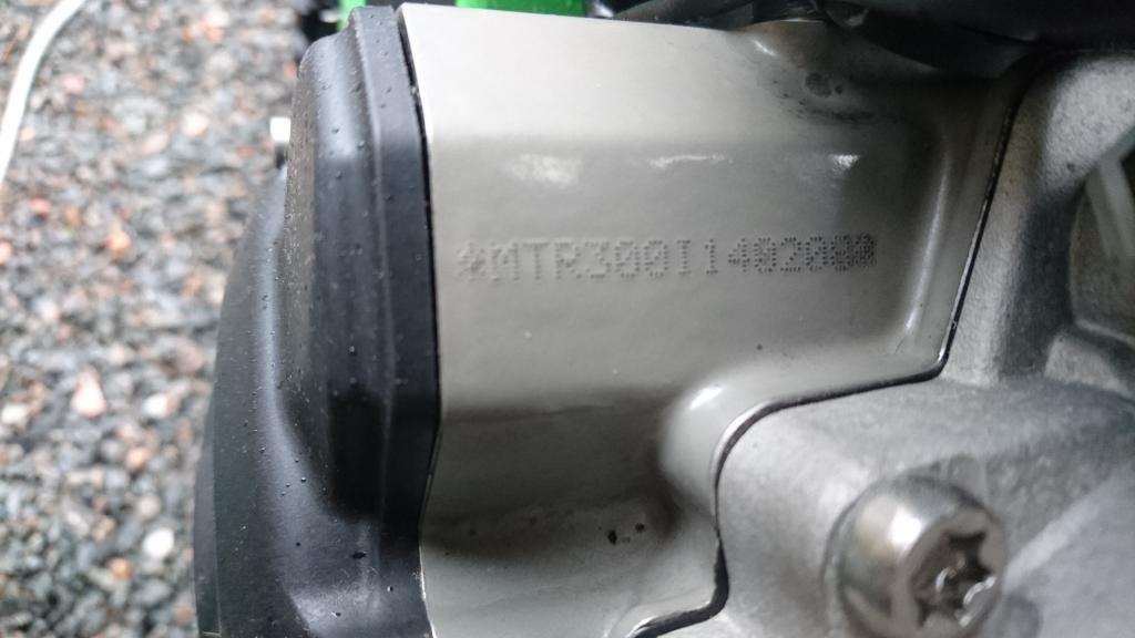

Hello,
I have a gap between the cover and the casing,is this comon?
I fill the casing with water when i wash the bike.
I have seen both carbon and magnesium covers,any sugestions?

It's not a problem, just a visual annoyance. There's no oil in this side so there's absolutely no need for perfect sealing.
Probably just not seated correctly. I'd take it off and see if the lip is damaged on the plastic (black) cover. Maybe need to straighten the lip with a sharper knife or a screwdriver to make it fit again.
When correctly seated the plastic cover should fit without a gap even without the bolts applying the pressure.

I actually had a level mark from water on the flywheel so i think i have to do something.
As long as the water get out it's no problem.
I did take it of yesterday and as you say there was no lip all the way around.

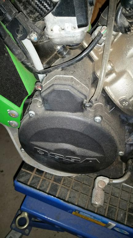

Hi JSP, here is a pic showing the location, and one pic showing the type of microsprinkler elbow I used. The elbow is held in with adhesive but is a tight push fit to start with to keep any moisture out. The hose routes up under the tank cover around the rad filler and then back down slightly so it is always pointing down.

I have a very small cutout from the lip below the cover (looks like straight from the factory, on my 2013 model cover). Just around a millimeter or less, when cover closed leaving a very tiny hole - just to let out the little oil residue from the bottotm or to equalize the pressure differences with heat expansion or cold contraction. Also when doing very deep fording (engine half-submerged) the water can't get in since the tiny hole on the bottom and the equalized air pressure keeps the water out.
Thus I see no point for additional weight with a top-mounted breather with a house - too much additional weight, bits & added complications, IMHO at least. Just make a narrow cut with a thin saw or a knife below on lip of the cover and you're done.

Ok, additional weight does not even factor in here, the dust on my bike at the moment weighs more than the tiny plastic elbow and hose! If so worried about weight why add the flywheel?
Ian, to your point, I have never had anyone say I over engineered anything before, I feel so proud! The problem with a hole in the bottom, or an unsealed case is that if you drop it in water and the engine cools quickly you will draw water in due to the thermal contraction. Taking the case off and wd40 is a good idea, but I was looking for a solution I could just forget about. I have not had my mag cover off for 2 years.
