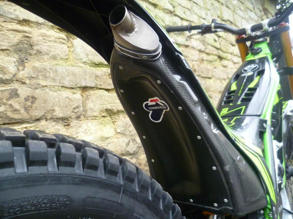

Here's a simple guide how to repack Termignoni on OSSA. 1st take it off of course:
2nd undo the rivets with a drill:
3rd take off the backplate, mine was siliconed, needed some serious work to get it off:
4th start taking off the old packing - use gloves and I also recommend a well ventilated room or better use painter's mask, it's a nasty stuff when gets airbone, the fibers and all the 2 stroke burnt oil crap will get into your nostrils and lungs:
5th take off as much as you can. Since I use two-compound packing (plates and soft-packing) I left the outer plating inside (packing plate some few millimeters thick against the exhaust walls) since it was in very good condition. What wears out is the packing near the pipe, hence I removed that:
6th, since the piping damping (metal debris packing) was in good conditions I left as it is. On very old exhaust you may have to change that and repack the pipe's surface. Put in the new fresh packing, as said I used the soft packing for the middle parts. DO NOT pack too tight (the lid should go on with little resistance) but also not too light. Just right amount with some little resistance, you'll feel it - nice and comftily tight enough. If too much or too little packing it will be louder and packing doesn't last as long.
7th re-rivet, I also ued a black high-temp silicone to seal the lid, it also reduces/dampens the sound:
8th, yer done. I wasn't conservative with the silicone and I didn't do any beauty work, for me the function is more important.
