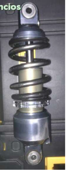

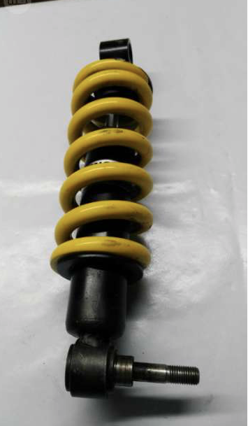

Hi, can anyone tell me what the difference is between the 2003 shock and the 2006 shock? and if I could mount 2003 model on 2006 rev?
I attash two picture with them post-20403-0-21322600-1464111300_thumb.png 2003 model
                                                 post-20403-0-80848900-1464111309_thumb.png 2006 model
Thank you, and sorry for my bad english...
You need to find a Paioli shock the same as you have, The rev 3 has no linkage so the shock is a special design rising rate. Why no get your old one reconditioned. The yellow shock will not work properly in a REV3.
The old one is broken...and here in romania i dont find a shop to repair or to buy parts...
