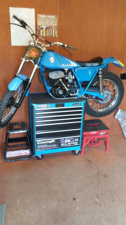

I have 159 Air box on my A same as bultacorock there is a few mods needed to fit these but easy enough to do.post-12321-0-76274500-1466931759_thumb.jpg
