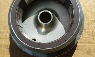

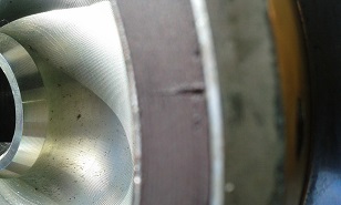

Flywheel Magnet Crack.
took the flywheel off today and found this.
It runs fine, anything to watch out for ????
also where can I get a puller for it from. Tried local bike shop, nothing.
Thought size was around 32mm 1.5 maybe.
Had starting problems after washing the bike. can see the flywheel past the warped plastic cover.
Fly wheel off and clean up water. Still wouldn't run. checked and no spark.
Lots of head scratching, power seem ok from coil.
Faulty stop switch was the problem.
whitehillbilly
I would imagine Dave Renham @ In Motion would have a puller
  • 3 weeks later...
The magnet in these flywheels is a strip of flexible material, that looks very much like where the two ends meet.
