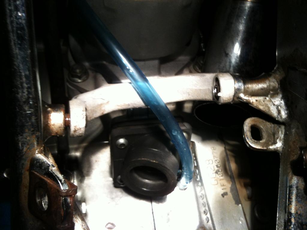

Could anyone be able to explain to me how to fit the breather pipe onto the crankcase on a Gas Gas TXT 280 2001.
I can't seem to see where it actually attaches.
Any help gratefully accepted.

there should be an right angles union which pushes into the crankcase near the front sprocket.
Quite often I have found these to be missing for some reason but you can purchase the steel angled union to which you can push your hose onto, they are interference fit so you need to tap them home into the casing with a small hammer
This is correct for the PRO if it is a EDITION (GG had both that year) it will be just behind the kick start hump in the center case hidden by the carb
This is a 01 280 EDITION

Thanks guys for all your help. At least I got a better idea of where it goes now.
