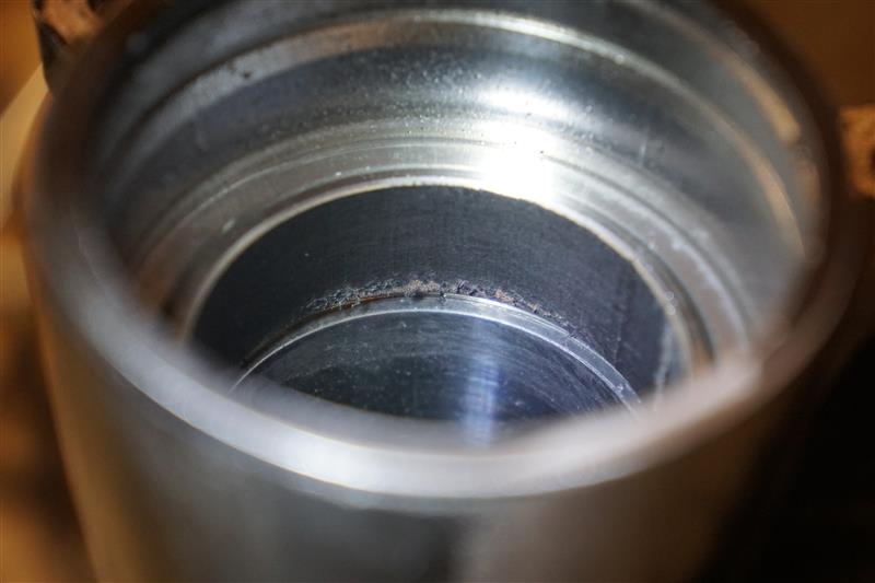

I took my Marzocchi fork apart yesterday (2013 GG TXT Pro) for service as well as to gt the lower powder coated.
When I looked at the bushings it looks like there is some type of thin film (teflon?) coating the friction side of the bushings.  Is this normal?

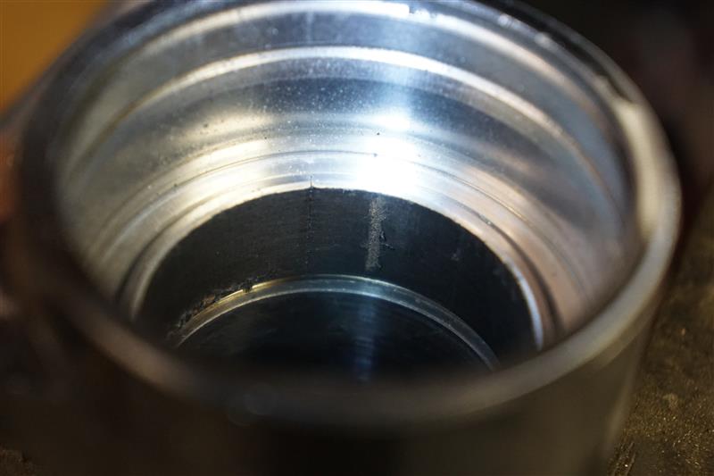

The film on the bushing inside the lowers are scratched?  (see photos below) Is that a problem?

 Don`t worry about it till you have new bushings in your hand. They will just slide up out of the seal cup. You can see the seam in the picture.

The tolerances between lower leg bushings can vary however when the fork has no oil in you should notice some play once the stanchion is inserted into the lower leg, however once the forks oil has been applied the oil fills the said tolerances between the stanchion and the teflon coated bush.  The damage from those photos should be something that needs to rectified (unless you want pinstripes on the stanchions).  Removal is easy as said by others, just pull them out with a blunt pick or alternatively you can buy a bush removal tool which is basically a rod, sliding hammer, a plate and a few nuts.
I would have the bushes replaced after the powder coating and also remove any paint from the surface where your oil & wiper seals seat into the castings and also the inner cast where your wheel axle slots and the pics bolt recesses/threads.  Ensure that the lower set of bushes are seated at the exact height into the castings as set from factory or else you may have a lot of movement and a fork which won't compress very far!
