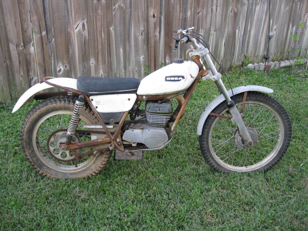

A Photo To Show What I Am Starting With 73 Mar
The work continues.  I had no major issues to get the MAR running and have ridden it around the yard.

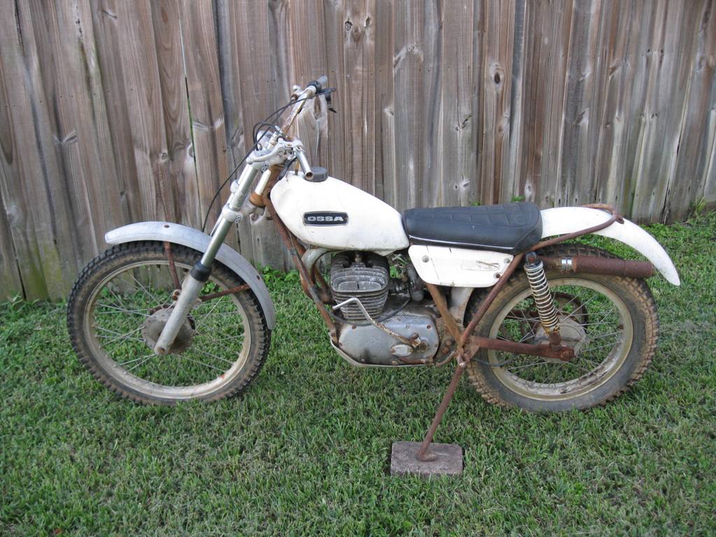

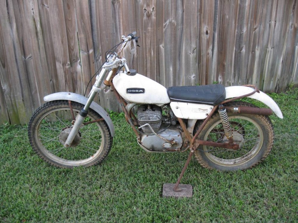

In early November I started this topic.  I posted two photos of what I started with, a 1973 MAR.  Picked up from the original owner, ridden but not destroyed.

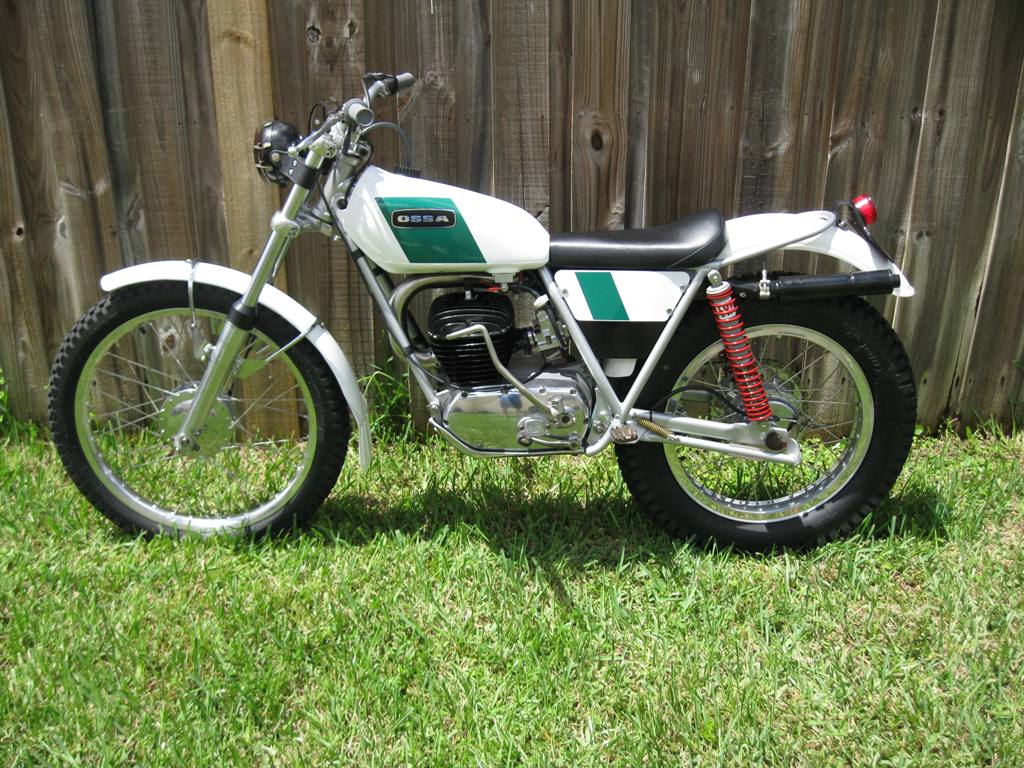

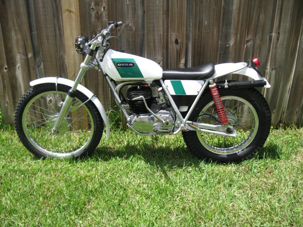

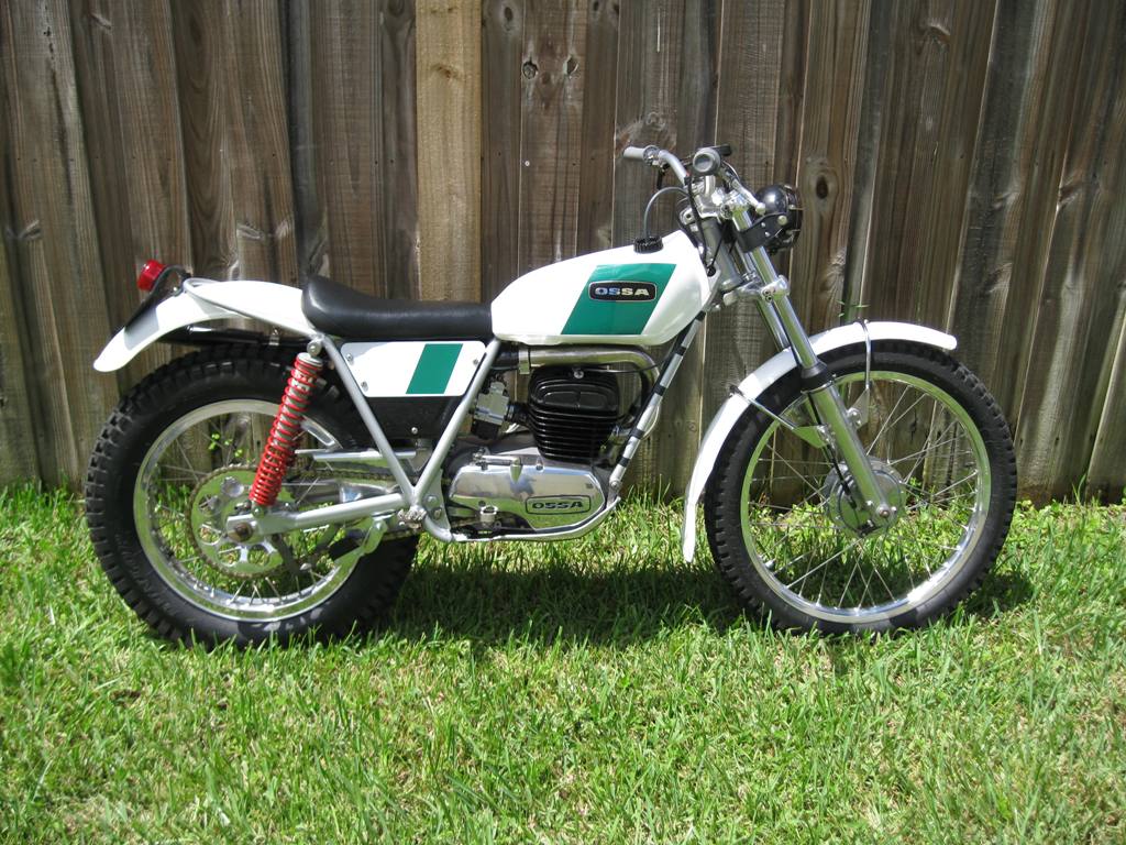

Months later, and I never planned to restore it to original, this is how it finished up.  Many of the original parts that were needed for my riding buddies MAR he is restoring to original were given to him.
Mine is pretty much done, except for lighting simply so I can get from trail to trail without too much hassle.  I have posted the photos on FB also, sorry if you have seen them before.
The before and after photos.  As it was when it was rolled out of the truck when it got to the house and how it sits today.

It turned out very nice.I have brought a few back from that condition and can appreciate the work that goes into it,many hours of hard elbow grease.
The tank looks good and will be hassle free.It is always good to see another one brought back from the dead. Well done!

Scot, thanks.
The fuel tank, one detail not visible or apparent in the photos is to drain the fuel, to prevent the tank from yellowing, I made it so you simply disconnect the fuel line, and then one nut secures the tank.  No removal of anything else, fuel can be drained in a minute.  Plus, no issues with the fibreglass...
