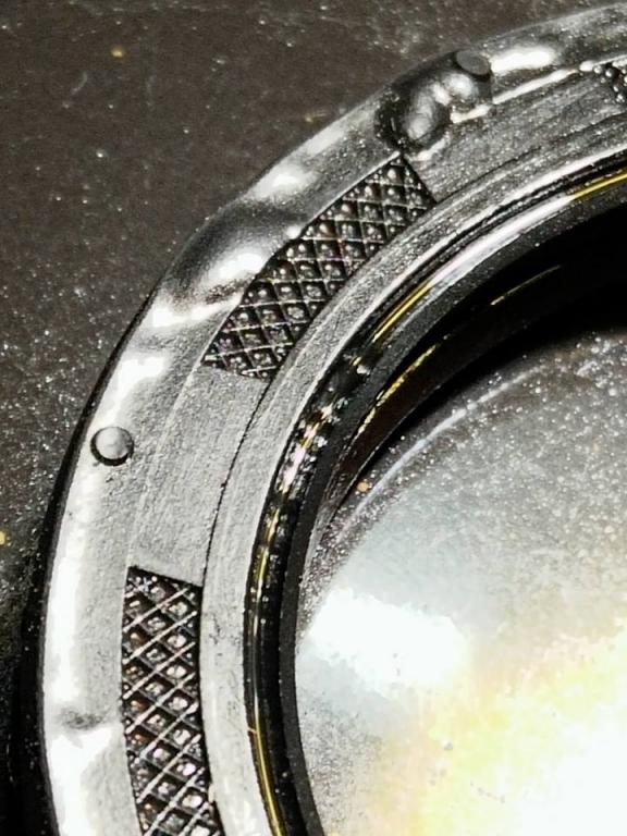

Update.
Oil seal 's rubber deteriorate. No groove on the metal sleeve.
I don't know how this happen but this bike parked for 2 years before i bought it. only 20 hours of use.
after change ,I let the engine run at idle for 10 minute. engine oil level still the same :D

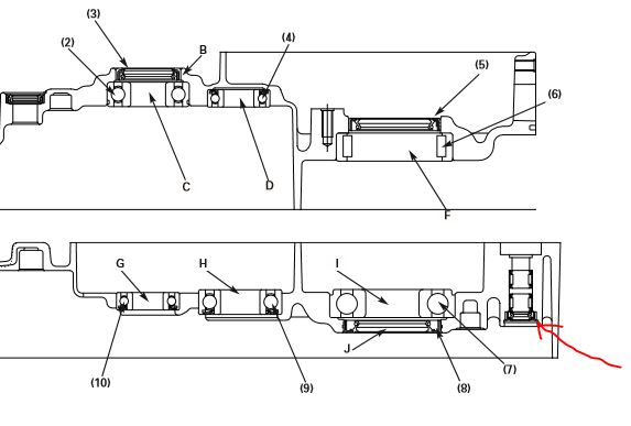

Is it possible that the engine oil pump's oil seal is defect ?
On 4/6/2017 at 7:42 AM, menglovekai said:
... Is it possible that the engine oil pump's oil seal is defect?
May be possible, but I think it's unlikely because:
1) Pressure should be higher in the oil pump, which would push engine oil into the clutch / primary drive case rather than the opposite, and,
2) The oil pump seal is fairly high, above the transmission oil level (unless transmission is overfilled). There could be splash that gets to that seal, but it's also recessed and away from oil slung by the primary gears.
Back to the first point, the pressure should be higher in the oil pump than the clutch / primary drive case. But if the transmission breather hose is blocked or pinched, pressure could buildup in the transmission / primary drive. That would increase potential for transmission oil migration to engine oil at the various seals or at the center-case gasket.
Sorry... probably not much help.
I would agree that a pressure issue caused by some kind of blockage sounds more likely the cause than the oil pump.  The other option could be that you got a defective seal.  Not common but can happen... :huh:
