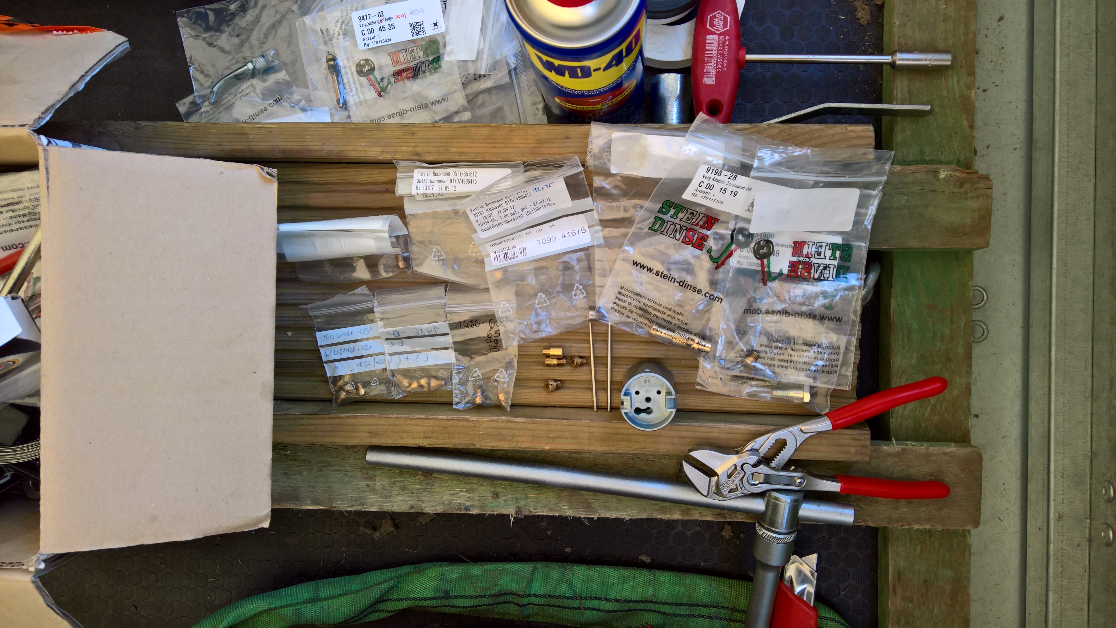

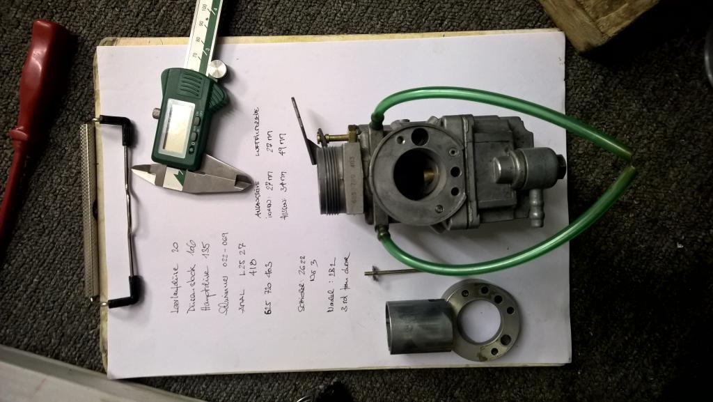

So did a test run and ... Mmmmh ... yes it's running ... but could run crisper, needs more idle and runs a tad rich in my personal opinion, adjusting the mounted carb did not change much beside idle rev. So I took off the carb and took a deep look inside.

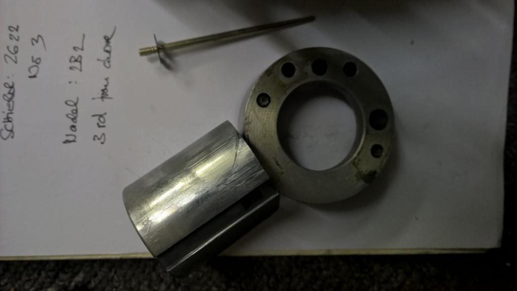

Well the carb need's an overhaul, the slide is pretty much worn out, never have seen so much wear :blink: !
The jets / all screws where assembled with maximum force, on screw that attaches the flange to the rear manifold towards the airbox was sheared, :angry:.
I would love to get this carb in decent condition back, what type is it as AMAL has some types of the MKII, is it a 2000, 2600, 2900 or a smoothbore I have no idea?
Printed carb- number at the top: 625  720  403
Printed carb- number at the side: L25 27 and below 418
So can someone please get me in the right direction which AMAL type carb I have here?
Below some pic's of the mess:

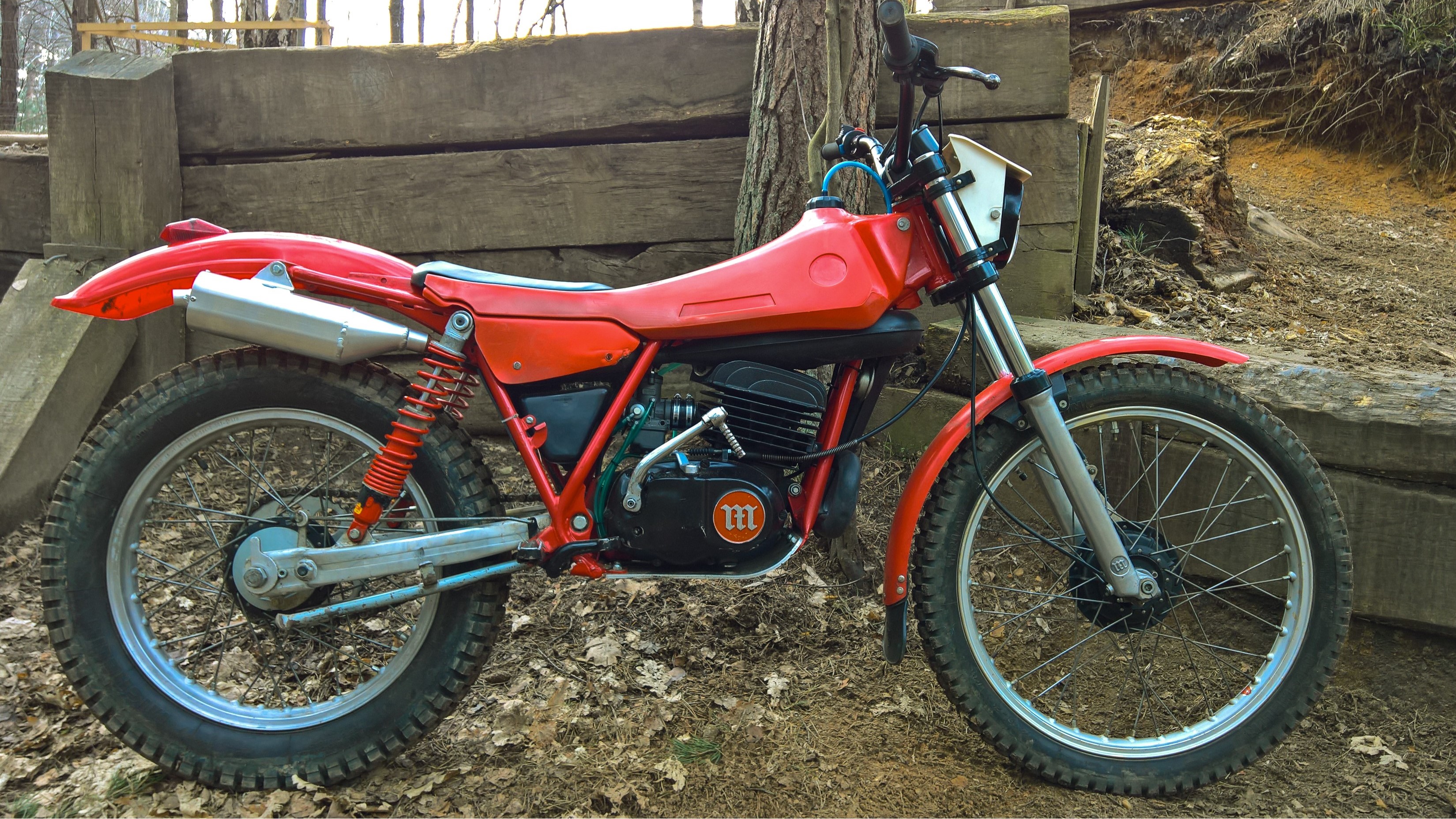

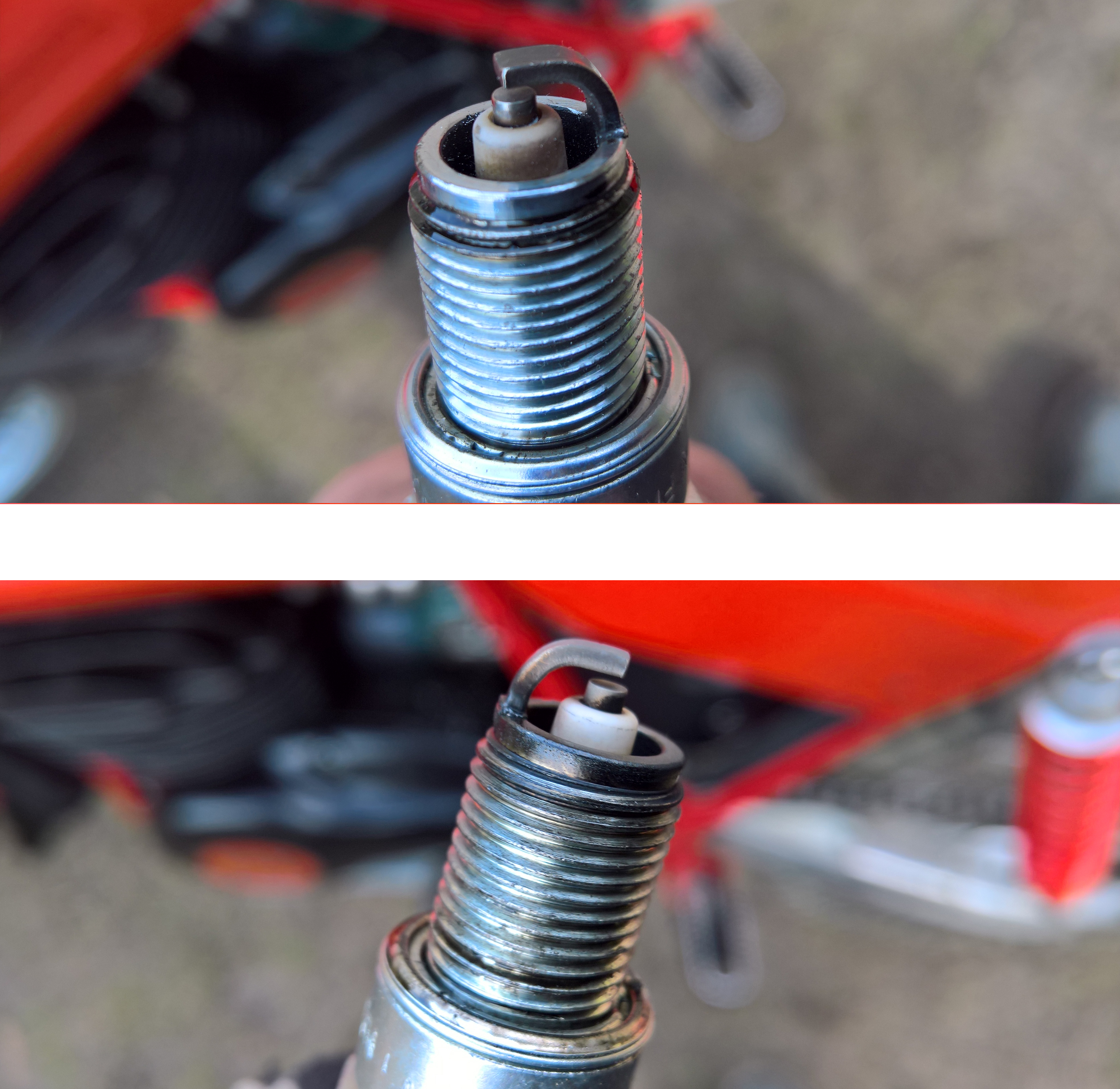

Testing days are over now.
I had some testing involved and finally got an good result, I checked first in the garage, than as usual decided to go with something different but at the field test out side I had to change again and again until being pleased.

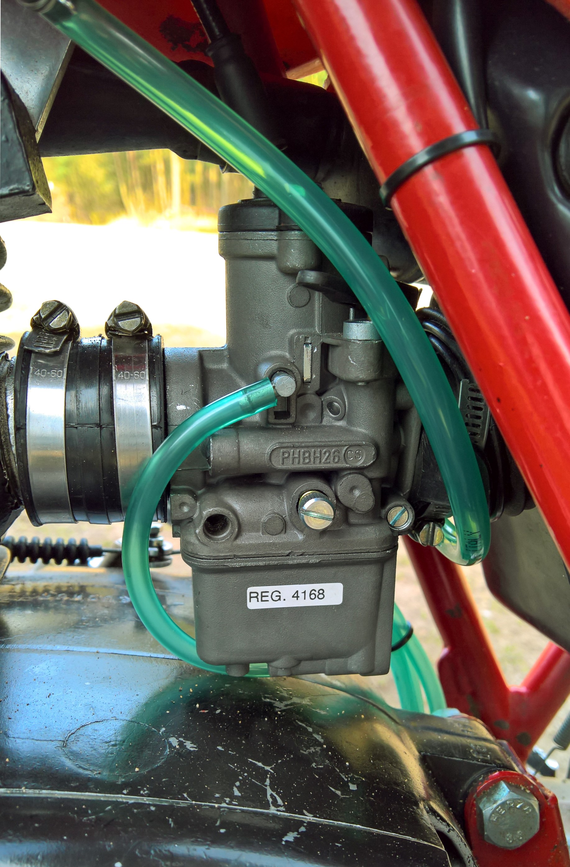

Montesa 242 now mounted with a Dell'Orto PHBH CS carb, (Yes with air screw as it's advanced in technology compared to the fuel screw type*).
I also exchanged the tiny original exhaust tube at the end for the aluminum WES type which reduces loudness a lot is as heavy or light because twice as big.
The result:
  1. carb:         PHBH
  2. type:         CS
  3. slide:         45
  4. needle:      X4 / X44
  5. position:    3nd
  6. choke:       60
  7. idle jet:      60 winter, below 10°, (58 summer)
  8. main jet:    95 winter, below 10°, (92 summer)
  9. needle jet: 266
  10. fuel valve: 200
* There is some rumor  that air screw Dell'Orto's are a pain, that's not true, they simply are a bit more difficult to adjust but can provide a better performance.To the air screw, it's just the opposite in adjustment, turning in means richer and  turning out leaner. The air effect takes time to affect the carb, for proper adjustment, use a slightly higher idle rpm, then really slowly turn the screw and begin with half a turn out until you reached the point where you have most rpm, then the air screw is adjusted. Anything below 1 turn and above 3 turns means you have to use another idle jet or nozzle.
Still a tiny bit too lean ...
