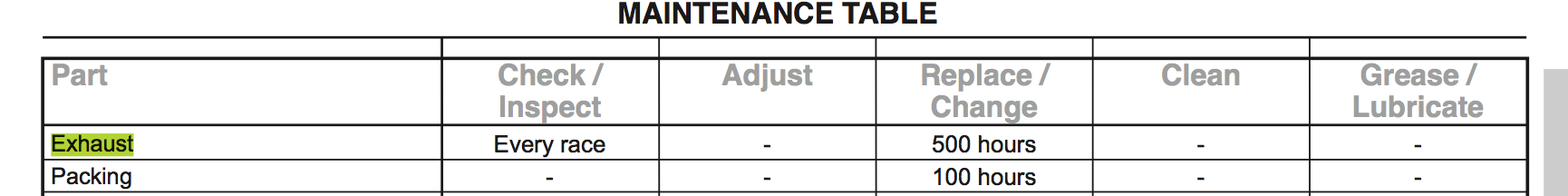

Luckily the manual actually tells you that every 5-6 trials (unless you happen to ride 20 hours at each one) is a bit ridiculous.

Every 100 hours must be about 30+ trials at least.
Or 20 sessions of 5 hours riding ... which can happen easily enough
Or, if you mess your premix up really badly, 1 session of 30 minutes :P

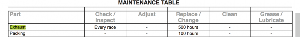

The maintenance manual also says to replace the cylinder and cylinder head every year. Do you follow their guidelines on that too?
