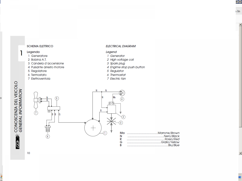

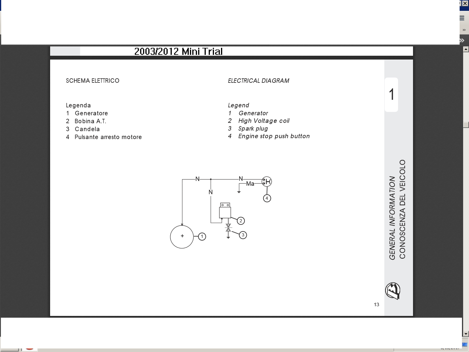

Does anyone have a wiring diagram for a Beta 50cc Minitrial please?  I have a brown wire that I have no idea where it goes.
Thanks
Normally it's the earth from the cutout button.Ma is the Brown Wire.
