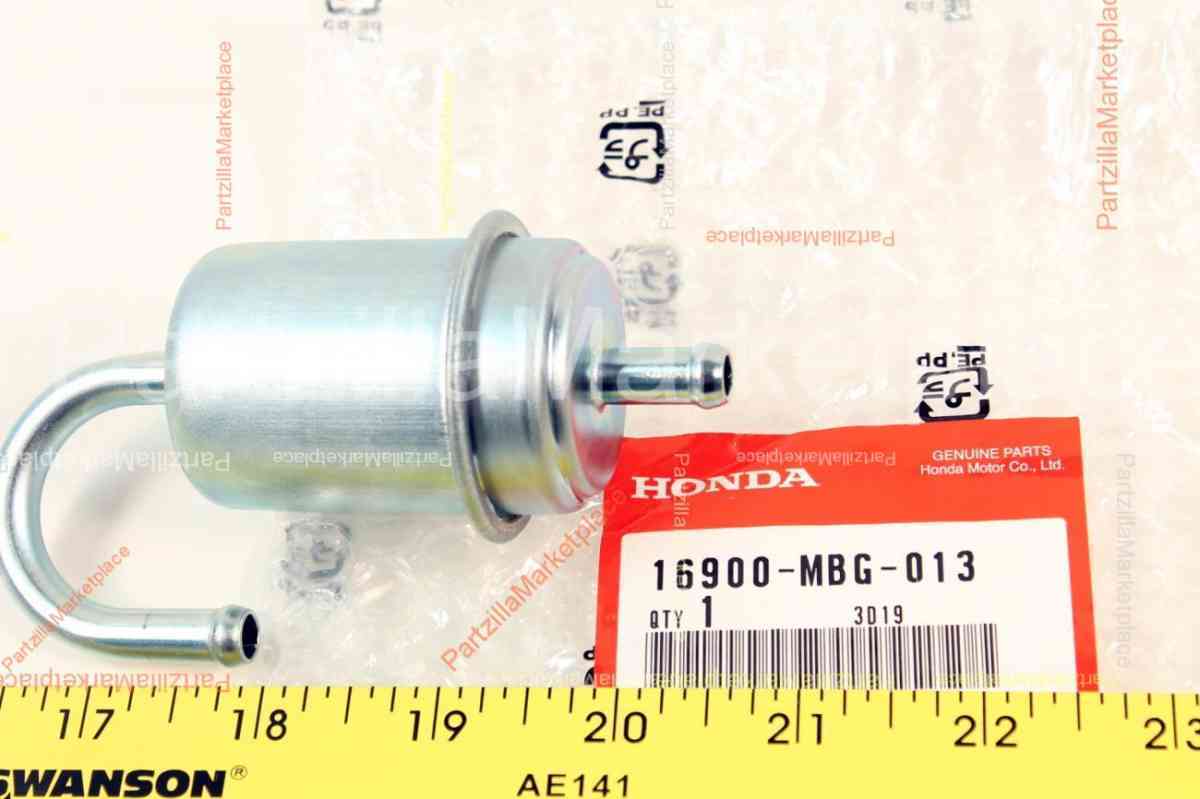

There's a similar Honda part on other models. Below is an image of one (taken from an eBay ad) that's common to larger EFI street bikes.
This one looks similar to the part used on 4RT fuel pump assemblies. But it might be a little larger based on the scale. However, there could be some perspective error that makes it hard to get an accurate sizing in the image. Sorry, but I don't have a 16900-MBG-013 to compare directly to a 4RT filter, so can't tell you for sure. You may want to check with local Honda dealers to see if they have one in stock for comparison.
