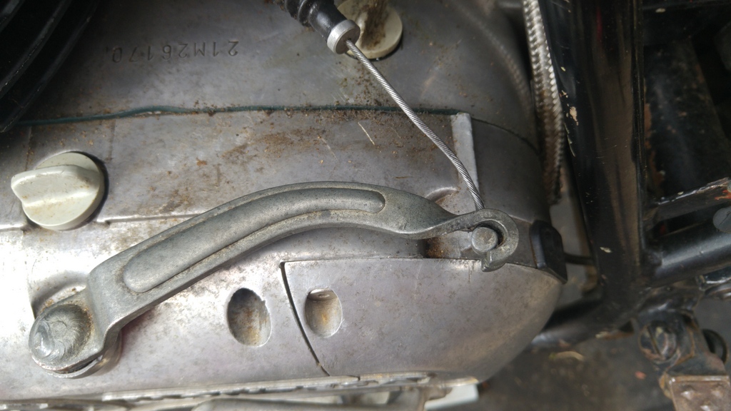

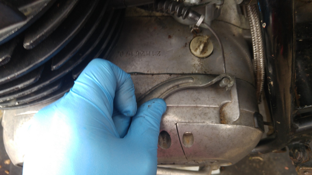

247C how much slack on clutch arm with cable removed?
Just wondering if my brass clutch thrust bearing is worn without pulling the cover off?
....with cable removed I have around just under 2" slack before the arm depresses on anything internal, from 'out to in' one might say...see pictures

Hi again - have checked mine and the clutch arm moves outwards to the same position as yours and starts to engage at the same point also, ie when the arm is level with the joint between the outer cover and the crankcase. I have had mine apart recently to change the gasket and the brass thrust bearing shows no sign of wear and the clutch works fine. So it appears you don't have a problem, thankfully.
