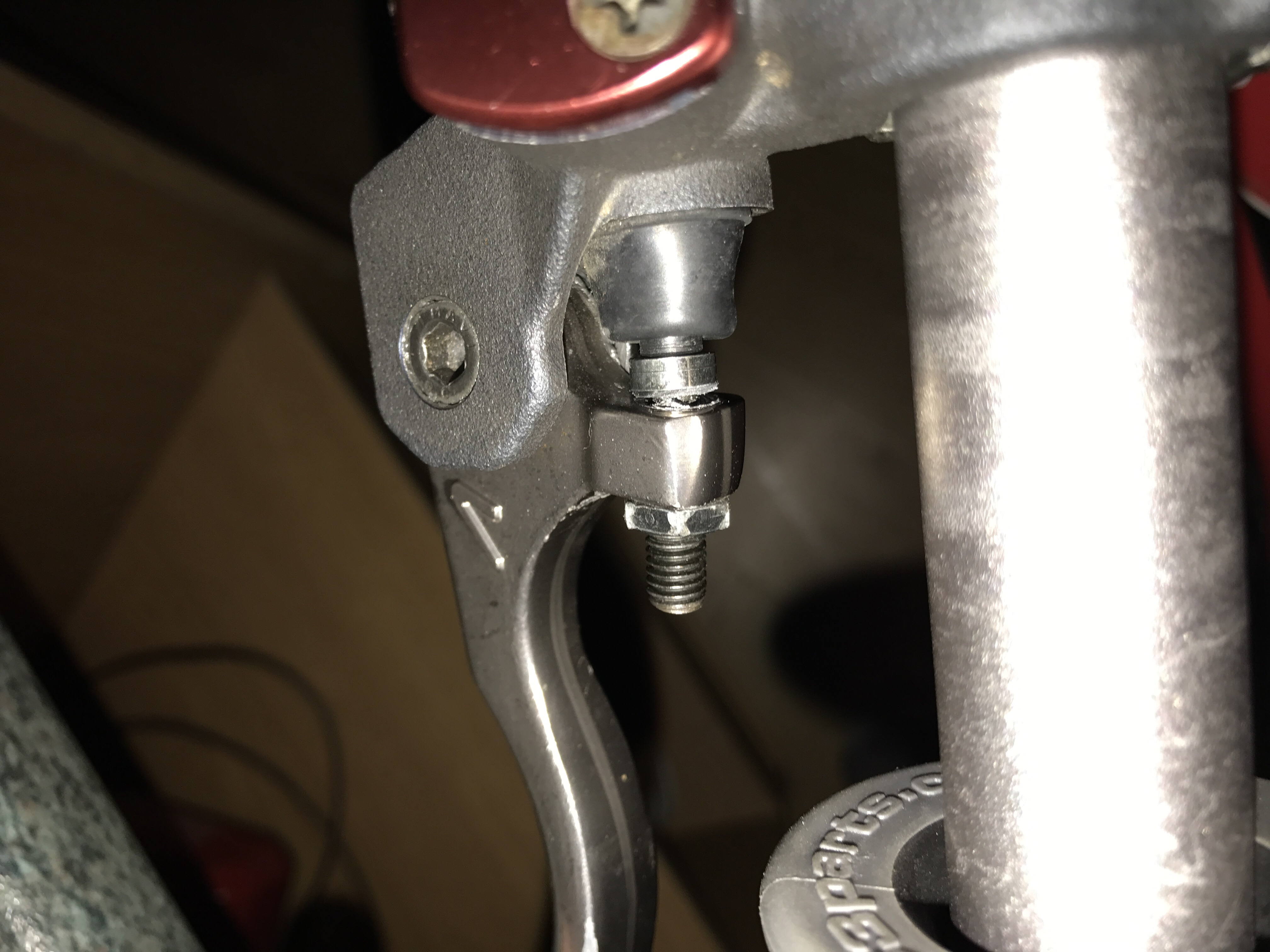

Yeah basically. And still the same with new clutch. has plenty of free play at the lever, but the plunger on the master cylinder hits the lever instead of the adjuster, as the adjuster is wound so far out to even have a bite any where near the bars. (Pic attached) The clutch finger height is adjusted by the clutch pack thickness and the thickness is bang on but the finger height is 2.9mm off. It's reading 14.6mm instead of 17.5mm I'm sure this is the problem but can't see how if one measurement is in the other can be out is there something silly I'm missing?

Sure you have the correct lever? Looking at your pic it is either wrong or you have the adjuster on the mc cranked all the way in.

Hi zippy yeah I think you right cheers I need some new plates to adjust the finger hight for now I have ground a small amount off the lever by the master cyl plunger to give me more adjustment it's still not right but was good enough for the resent trials ?
Lineaway yeah it's the correct lever ajp standerd but had the adjustment pin all the way out to get some sort of bite
