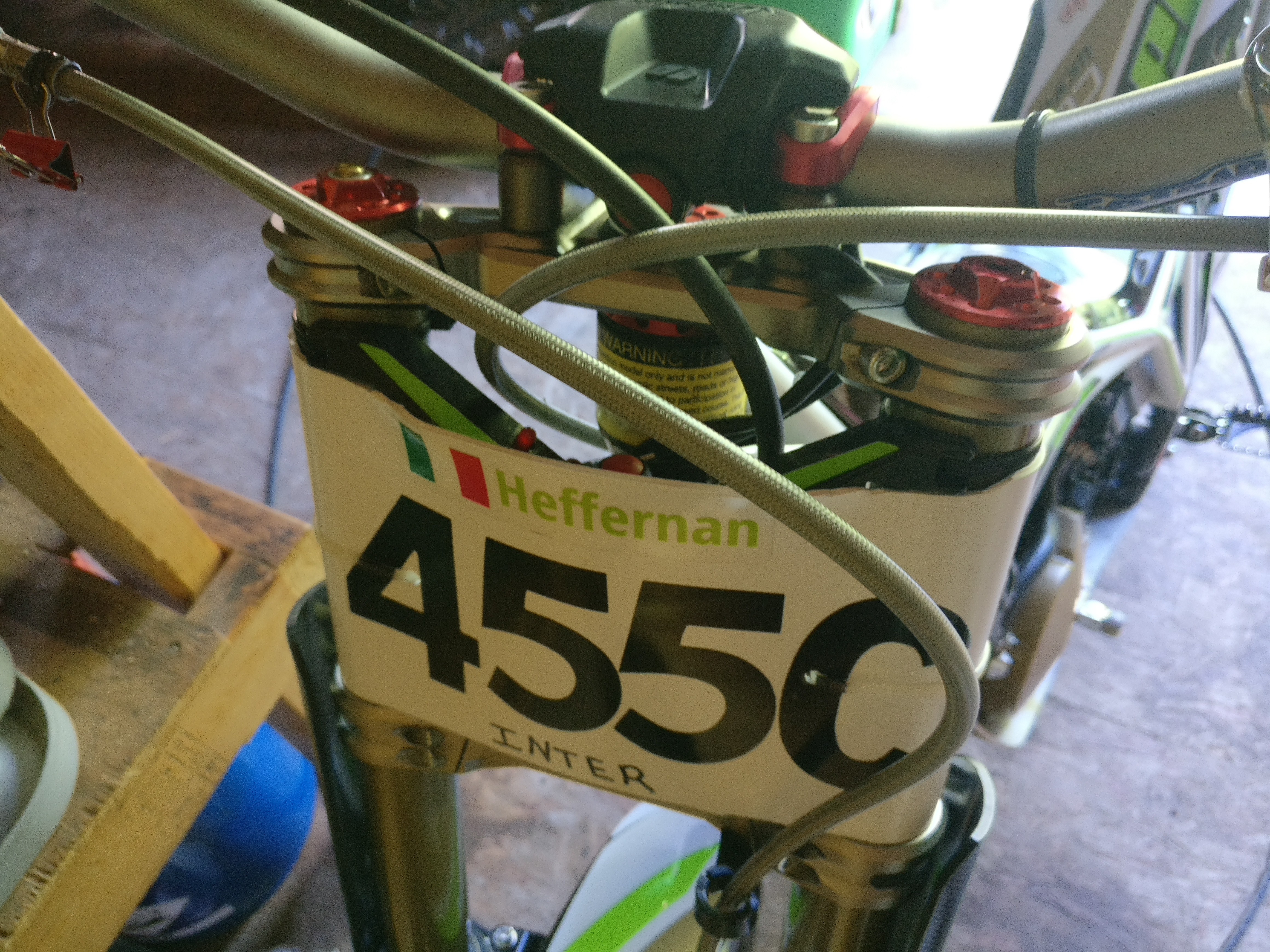

I use what looks like the usual hard plastic number plate, but it's flexible enough that you can put it on over the light, then you can just put a couple zip ties around it and the fork legs to ensure it doesn't go anywhere. Unfortunately I've only ever seen them at my dealer, and I have no idea where he gets them.

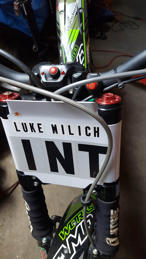

I pulled the stock light and board, removed the headlamp and buttons.  I then place the buttons into the foam bar clamp protector and ditched the lamp.  This allowed a normal board mount (formed plastic clips onto the forks) and better button access.  These thong bikini boards (my Ossa had a similar one) are pretty useless as is the headlamp, much prefer a standard board with letters you can actually see....

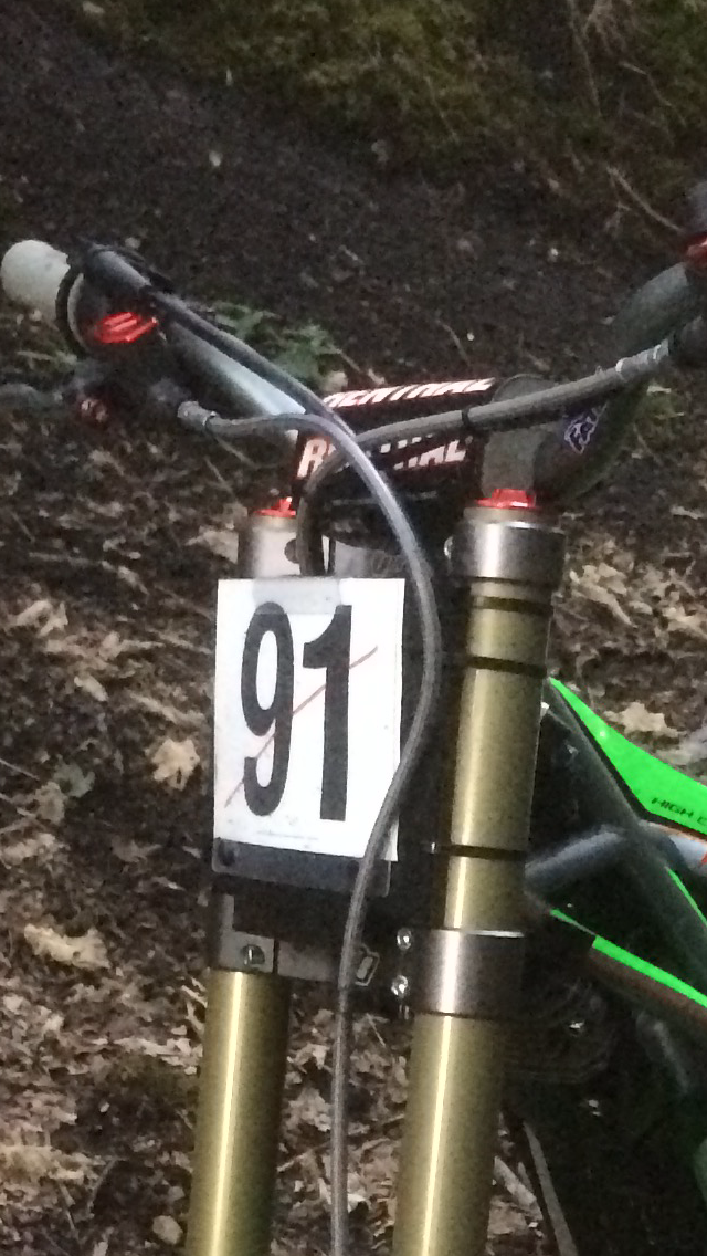

I've now fitted a standard number board over the headlight
and used a couple of strips of rubber under the board on the fork
legs to level it up the best I can, I've also used reusable cable
ties as I'm not keen on the look so I can remove it and only use it when I need to

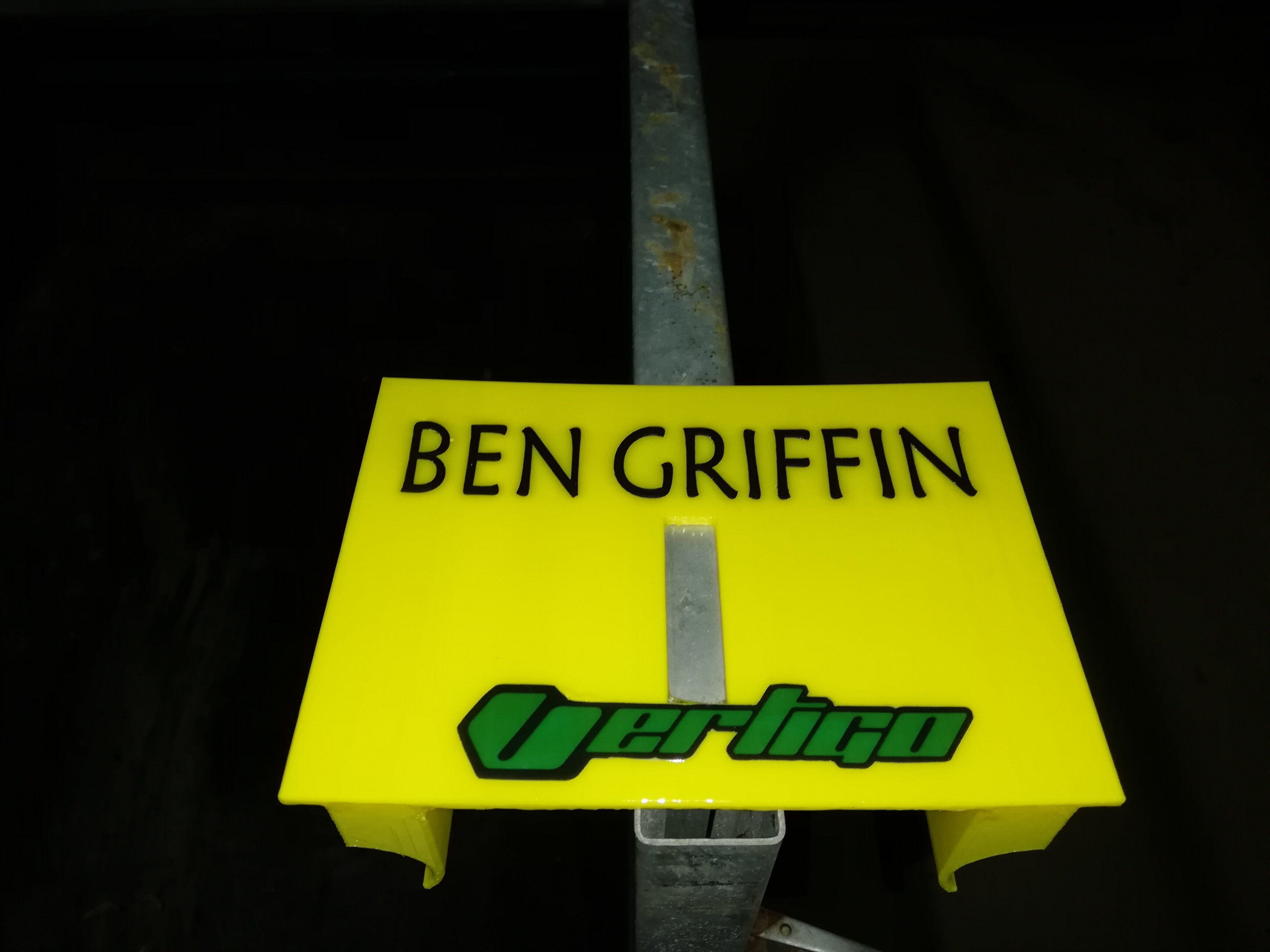

I made this one (3D print) for a friend who bought a Vertigo a couple of years ago.
Having just picked up my first Vertigo I will be tweaking this prototype. The nameplate clips on between the forks and clears the headlight. Easily removed when not in use and no changes required to the bike,  has a clear hole in the middle so the headlight is still visible.

Holster - that number board looks great! I'm looking forward to seeing v2. Please keep us updated.
