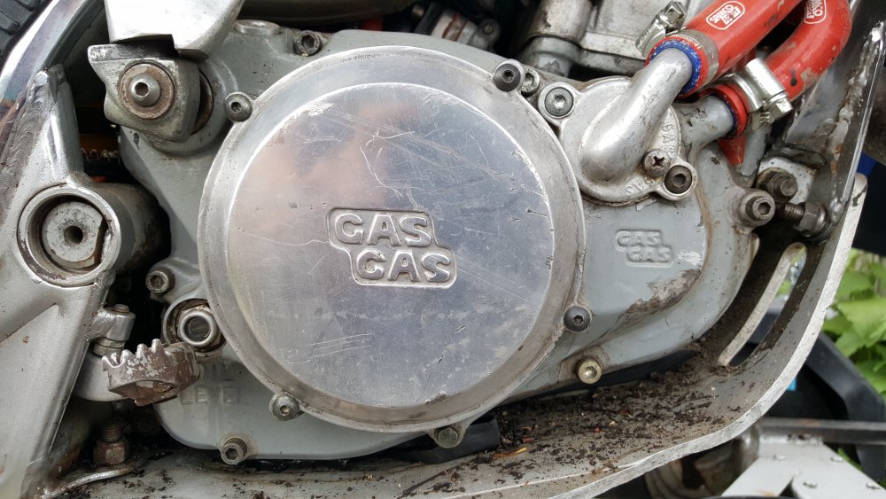

I have an oil leak :(  I think its coming from the crank case housing but havent investigated too thoroughly yet. ATM its running like a total loss system :) !
Couple of Qs if I may
Where would I source a new gasket here in the UK ? There seems to be a few trials type stores on these shores but is there 'the best' shop to go to here in Blighty ?
Or, does anyone make their own ?
And, I dont suppose there is such thing as a Haynes type of manual for these bikes ?
Here is my crank case. I think I have a 2000 txt ! ?
Thanks for any help
Carl
I seem to recall its just an o ring
Gasgas moto uk should be able to assist failing that your local bearing specialist could supply a length of material so you could splice your own and super glue it together
38 minutes ago, bilks said:
Have u checked your gearbox drainplug
I havent yet... Good point !!

Also check the primary (clutch) cover gasket after removing the skid plate.  It's possible for the cover to get moved slightly on impact thereby breaking or dislodging the gasket.
