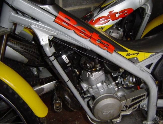

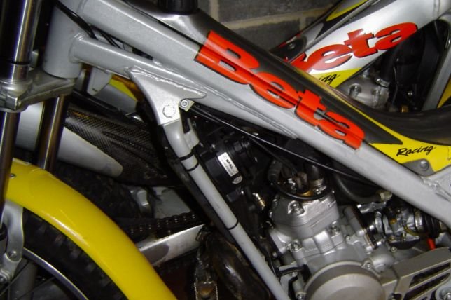

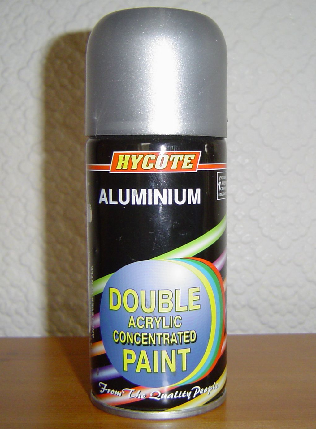

post-1239-1133356834.jpgHi this is the paint I used to tidy up my sons Rev 50 and Rev 80. I bought it from a local car accessories shop and used an undercoat from the same manufacturer first.
Edited by GWREV3
This is what the paint looks like on, as you can see it's wearing off again where his boots rub, but it has had 11 months of wear and tear. Most of the Rev 50's/80's I've seen go like this and I think the only way to get around it would be to have the frame powder coated.

Yes ,the colour was a pretty good match. If you enlarge the photo and look, the area I painted was the frame from the footpegs to the point where the cable comes through under the fuel tank. The steering sleeve and the bolt-on section of the frame that goes down the front of the engine were both masked off and are the original colour. Theres also an area around the Beta decal that's original.
Before spraying, I removed all the rear end plastics,the footpegs, the air filter assembly, the rear brake pedal assembly and the swinging arm (I took the brake calliper off the swinging arm and let it hang loose.) I masked the Beta decal under the fuel tank after removing the tank and covered everything else that didn't want painting with a bin bag. Obviously, the area nearest the footpegs wanted the most paint but moving towards the steering sleeve, I tried to blend in by hardly putting any spray on. The paint I used was made by Hycote and is double acylic concentrated paint, the colour is aluminium. The address on the can is;
