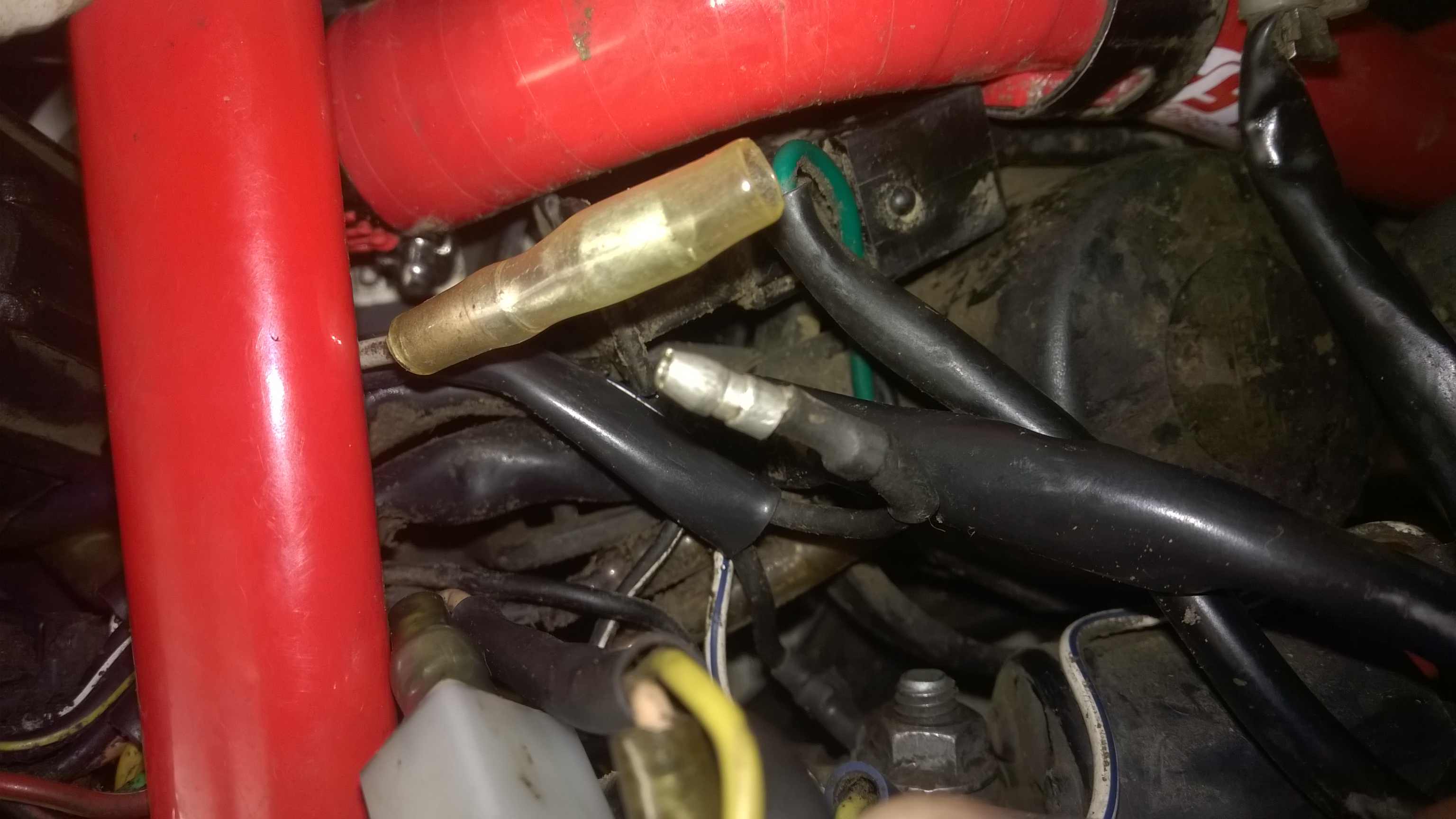

Hiya everyone. I bought a 2010 pro and the thermostat has been bypassed and its been wired so the fan is on constantly.
I want to wire it back in with a new thermostat.
can anyone tell me where the thermostat wires connect please.

I have the two wires coming out of the thermostat ( both black ) but don't know where they connect to. Its a thermostat in the top of the rad not a inline one

the female bullet(white wire to rectifier) is the only one that's been altered (earthed to frame) from what I can see. The other wire on thermostat looks like a earth wire

all working now. Put a new thermostat in then connected the white wire with female bullet connector from rectifier too the wire on thermostat wire with male bullet connector (some rectifiers have two yellow wires instead of a yellow and a white) and earthed the other thermostat wire. Like in this diagram.
