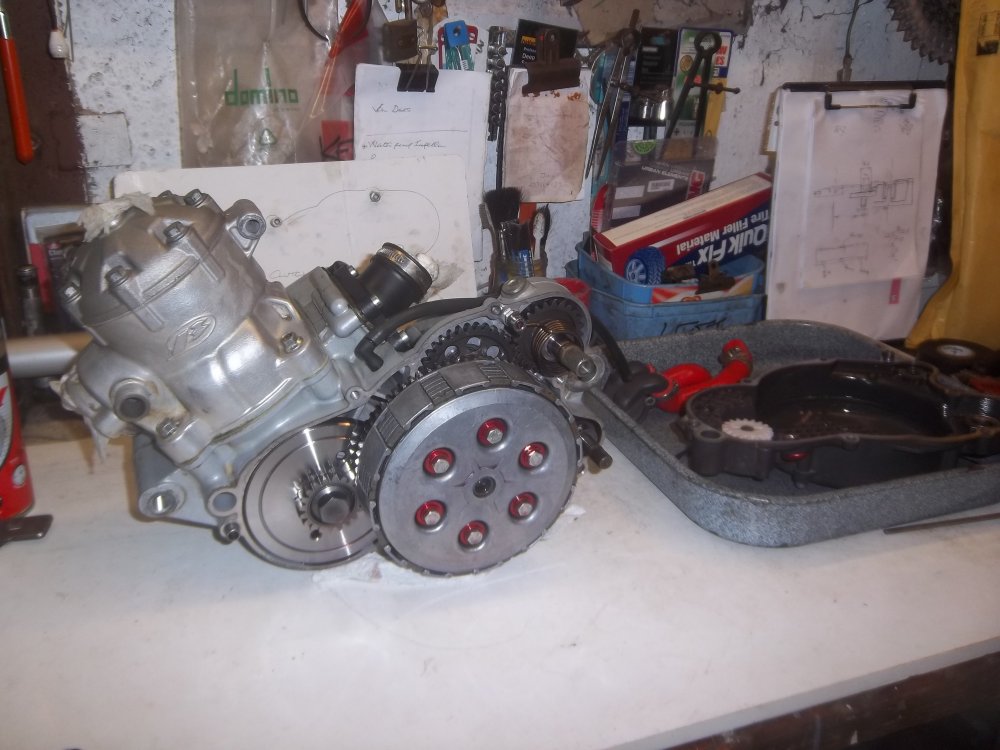

The Evo Factory models -at least my son's 2011 Factory 300, had special red aluminium washers to tension the clutch springs.
These washers are top hat shaped, a larger diameter brim and a smaller diameter body,  By turning them over you can adjust the tension of the clutch springs. Take one off and have a look if you have genuine parts.
If the flat brim is towards the spring (with the smaller diameter section visible next to the bolt head) you get maximum tension. If the smaller diameter goes inside the spring, it does not compress the spring so much so you get minimum tension.
See photograph attached, zoom in and you can see that the top hat has the brim towards the spring for maximum tension on my son's 300.
It is easy to try them all (or alternate ones) in the other position and see the results.
