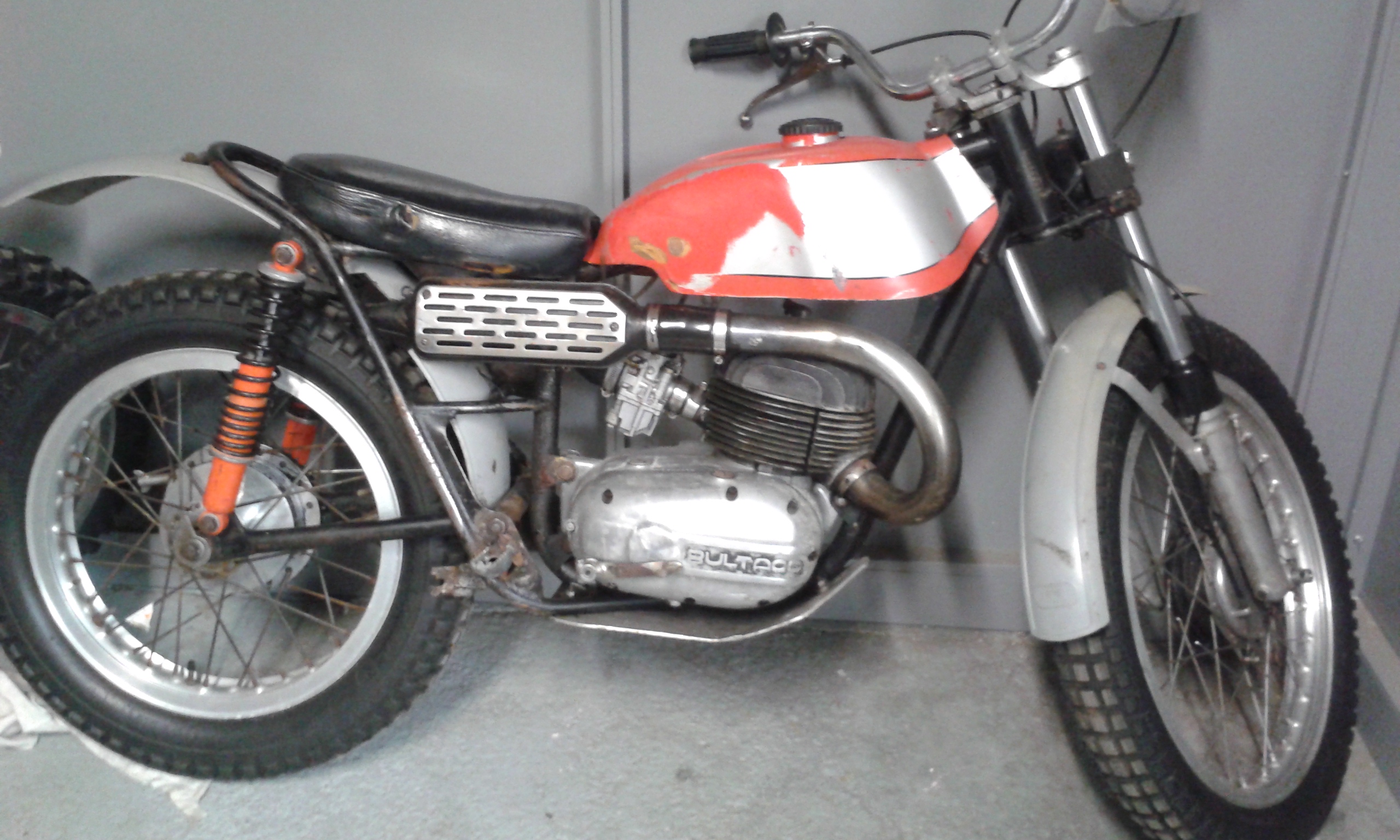

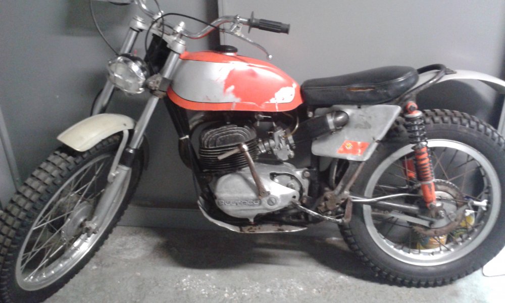

Hi Jon,
I will definitely post photos of her progress.
I'm just waiting for the chainguard to be made, as the bracket on top of the swing arm was cut off at some point and I need to mock up the chain guide and  chainguard to set the correct bracket location before I strip her down!
this is how she stands now. The photos aren't the best as my phone camera isn't too good.
all the best
The clamp that's on her will do for now but it's the original I'm after.

Fabulous looking bike there Gary. Thanks for the photos. M27s are not often seen on the forums and I've never seen one in real life.

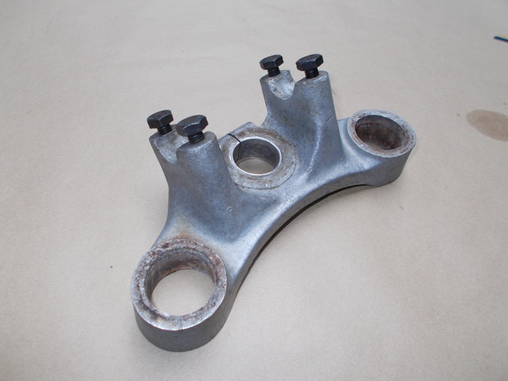

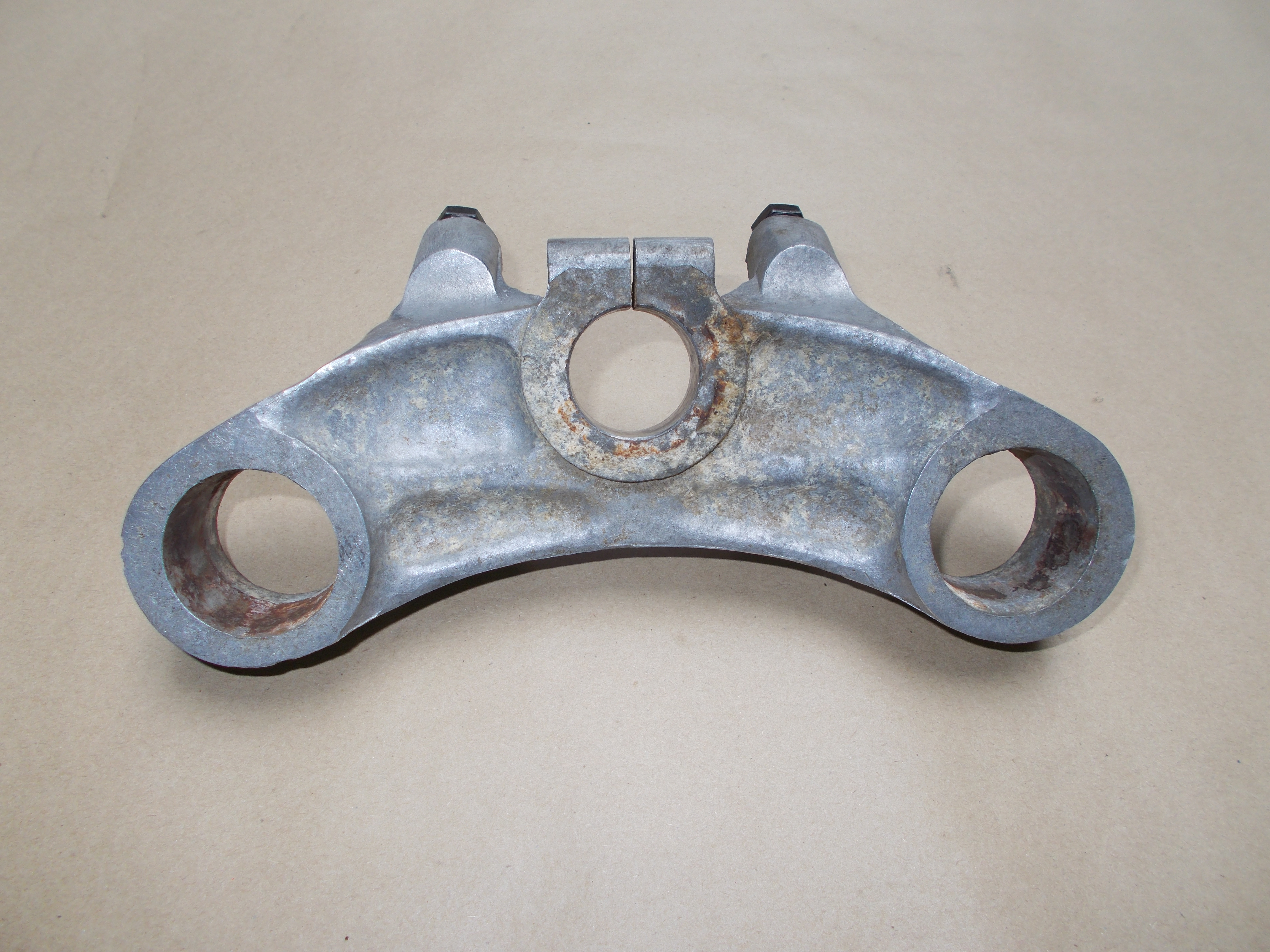

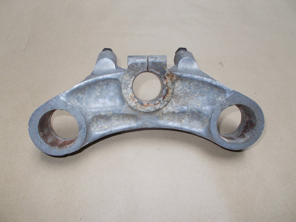

The fiirst M10 that I owned was fitted with a rather sturdy top yoke with clamps similar to the later type. The stalks supporting the handlebars were best described as flared into the top of the yoke part. After a bit of research I found that this part was an after market replacment made by Sandiford in the UK.  I believe others also made replacements. These were made and sold due to the original parts being a bit fragile and prone to breaking. Given a choice I would prefer one of these after market parts as they were stronger and also still a period part/mod.
In my many years of Bultaco ownership I have broken a top yoke only once and this was a model 80 later clamp type. Came to a rather abrupt stop at the bottom of a ditch and the yoke snapped with my full weight hitting the handlebars.
Stuart
This post by twinshock answers a question I've had for a while regarding a mystery top yoke I have on a M10 project, originally thought it was a Sammy Miller item but it never quite matched the picture I never knew that Sandiford made them !
These are photos of my top yoke they look identical to me anybody have any ideas what other aftermarket items they made for Sherpas ??
This forum is great the way if you follow the regularly posts about one bike answers other questions keep up the good work.

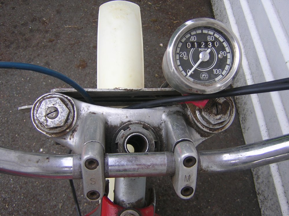

This is the top yoke fitted to a model 10 I had up until 2009 since gone to France. Assumed by the "S & M" stamped on the clamps that it was a Sammy Miller item, different to the one shown above. Bike was also fitted with what I assumed were a Sammy Miller brake pedal and mudguard stays, and an M27 "style" alloy tank with monza cap. Oh and by the way those are what I believe to be the original  handlebars with built in perches for the levers.
