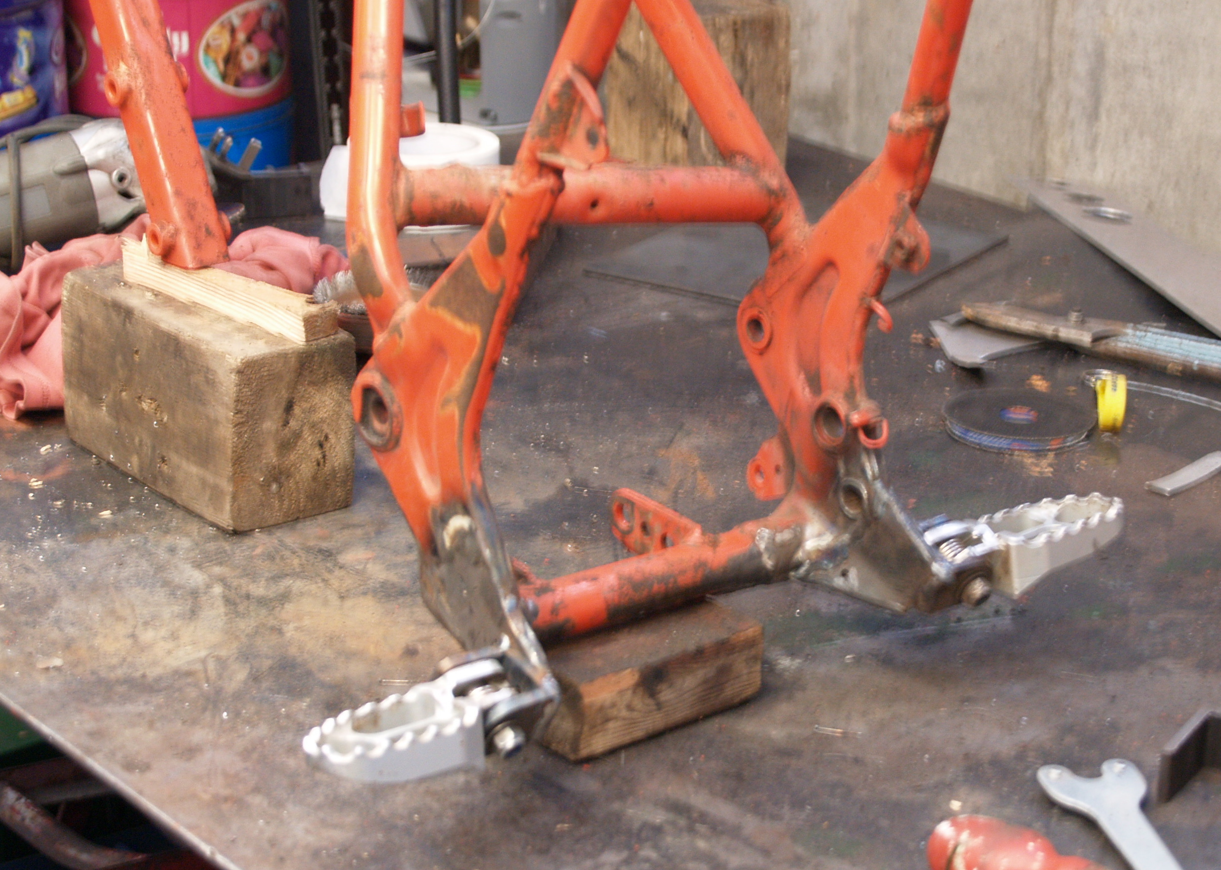

October 29, 20179 yr Author OK , Thanks Bashplate.How difficult was altering the steering head angle? I'm a reasonable welder, I've already done the foot pegs. 1" down and back. I was just trying to see what the end result should look like.
October 30, 20179 yr nice job on the pegs there. what I did with my rake angle, was cut the top tube and mildly heat the down tube to the front of the motor, just bellow the bottom steering bearing. Did it all with the wheels still mounted, and pulled the front wheel in with a ratchet tie down strap between the front and rear wheels. Just pulled it back till it looked right, about 6mm gap ( may be 7mm) in top tube was about 25ish mm at the wheel base. Then just fill in the top tube with 1.5 or 2 mm plate. Keep the ratchet strap between the wheels while welding to help stop the top tube shrinking as you weld, as it will pull your wheel base out again very slightly.
