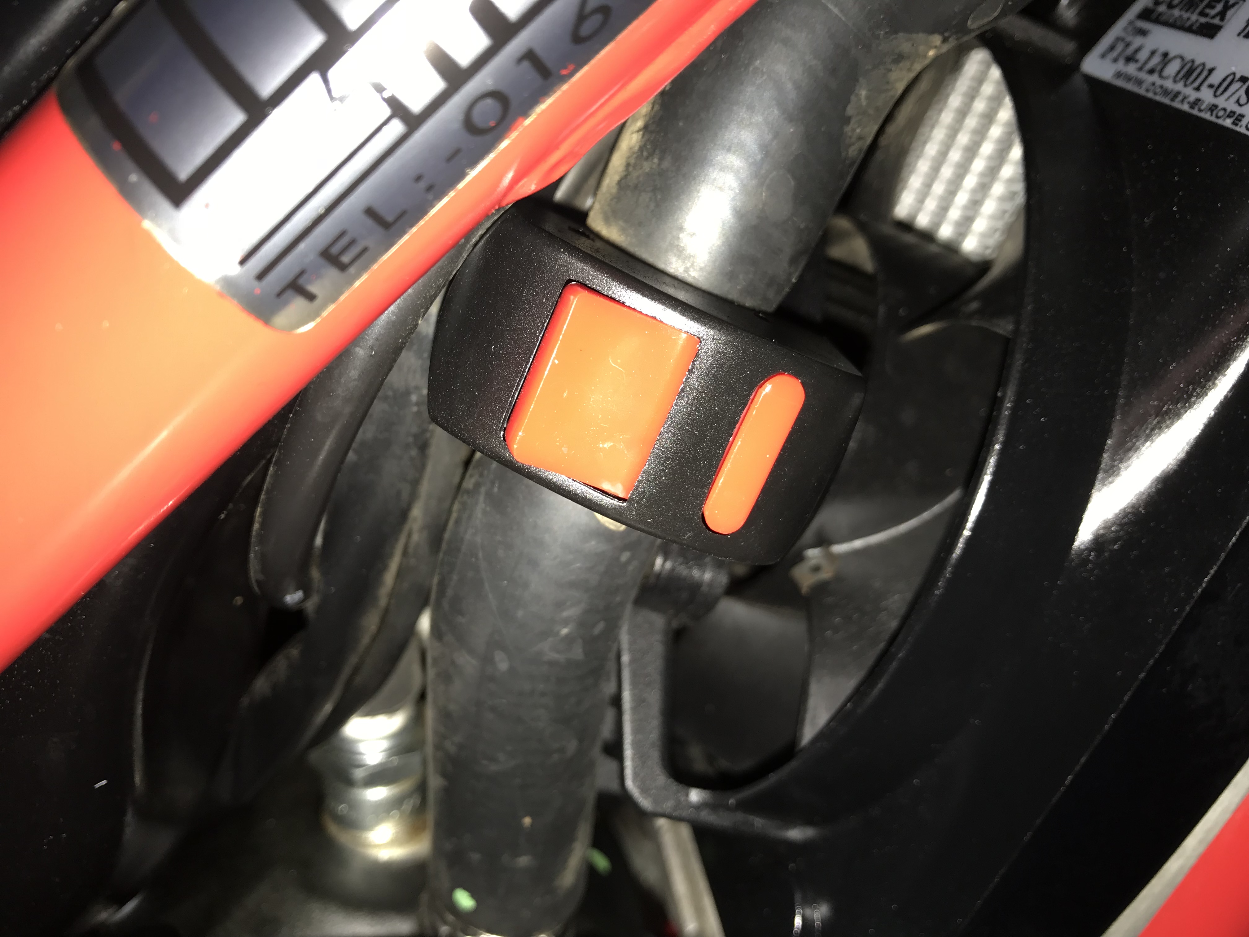

September 24, 20179 yr Just bought a gas gas 280 2012 model. Can anyone tell me what this switch is for ? Can’t seem to find an explanation for it in the manual . Thanks
September 25, 20179 yr It's the map switch. Large button selects normal ignition map for dry conditions, pressing the small button selects a softer map for wet conditions. But in my opinion it's makes little difference.
September 25, 20179 yr placebo effect switch. Tested it with a timming strobe and it act in ignition advance and give your engine a sligty softer behavior. But the effect is small on some engines. https://www.youtube.com/watch?v=XkJQsVgMTLE Edited September 25, 20179 yr by cascao
