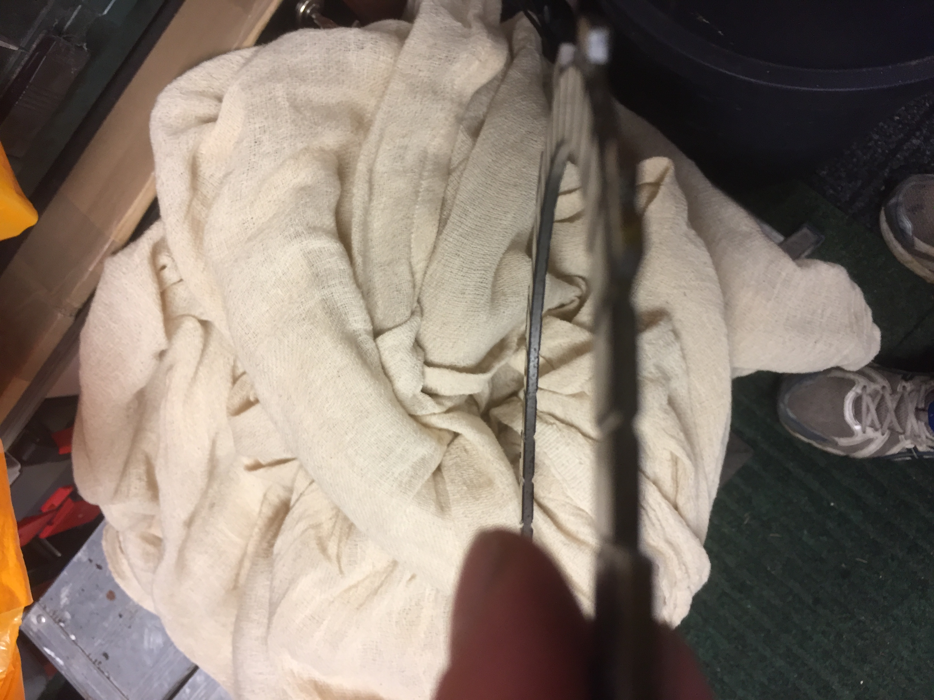

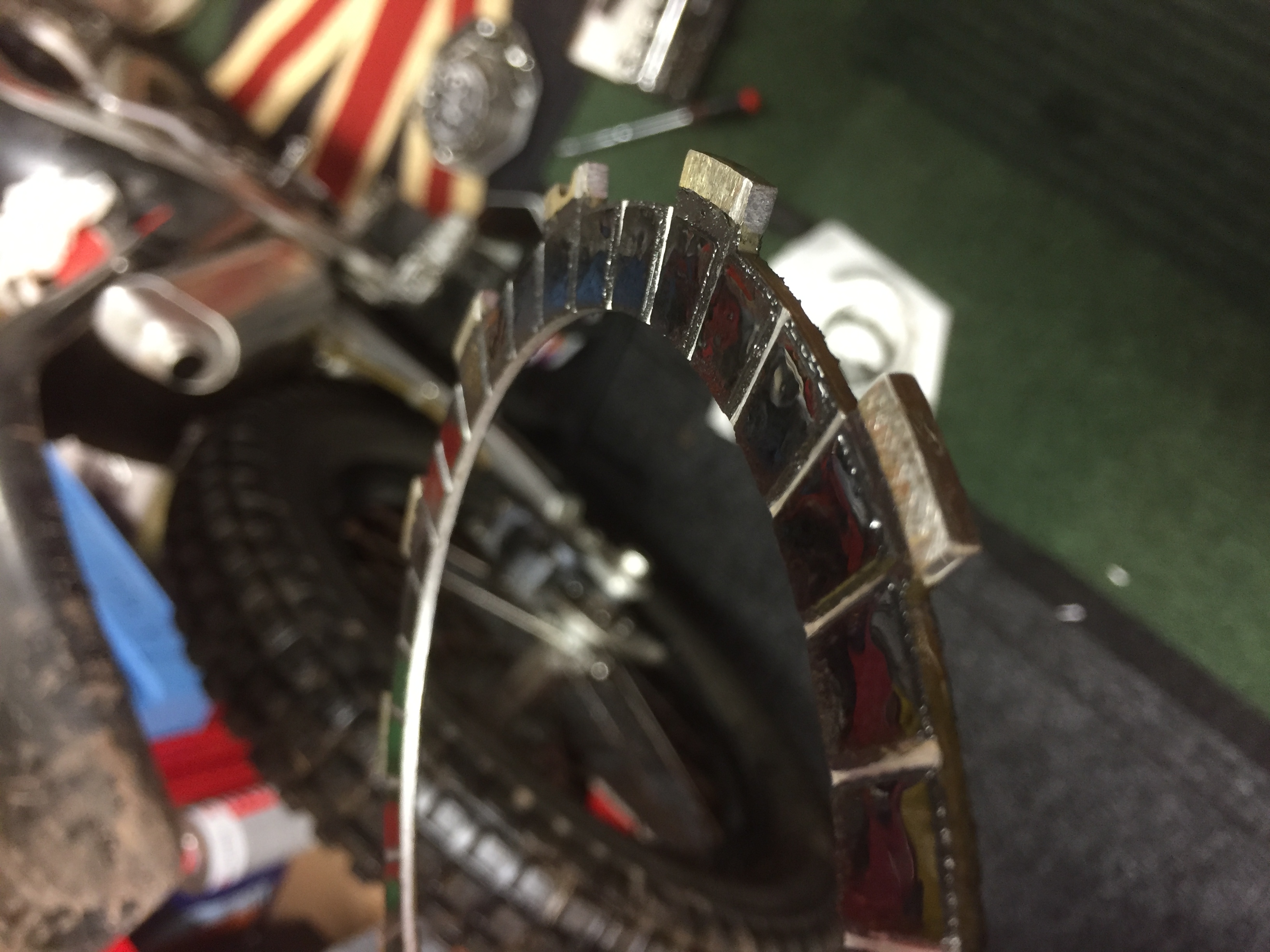

November 3, 20179 yr Need some help please guys. Was out today on some hills and bike was fine to start. But as the day went on the bike was reving at the tops of the hills but lacked drive. It got worse and worse as the day went on to the point I had a couple of tumbles as the bike could not make it to the top of the hills. As it’s in all gears I assume it’s the clutch friction plates that have gone? Have taken them out and look to have about 0.5mm on them. Is that worn out or should I be looking at something else . It’s a 2002 315r if that helps and here are some photos. Any advice would be appreciated ?

November 3, 20179 yr According to my 315 manual,the clutch plates should be 2.65 minimum,and the springs 35.5 minimum,but what Dan says sounds very likely,seems strange that the clutch got that bad that quickly
November 3, 20179 yr Author 1 hour ago, huski said: According to my 315 manual,the clutch plates should be 2.65 minimum,and the springs 35.5 minimum,but what Dan says sounds very likely,seems strange that the clutch got that bad that quickly Thanks Huski, do the friction plates measure 2.65 front to back or just the pad on one side. my overall thickness is 2.7 across the pad on both faces and 2 in-between the pads?
November 3, 20179 yr Author 2 hours ago, dan williams said: Sounds more like your lever isn’t returning all the way out and opening the bleed hole into the reservoir. So as the fluid heats up it pressurizes the system and gradually disengages the clutch. Also could be debris blocking the bleed hole. Thanks Dan, will check the hole and see if i can get a new plunger kit as i wonder if its just feeling its age. When i pull in the the lever the clutch disengages and engages when i let the clutch go, it just seems to struggle ir i put some load on it. is there a way to see if it is the plunger at the leaver or is it just trial and error ? sorry for all the questions its just a big learning curve for me as i cannot fix it with a hammer ;-)
November 3, 20179 yr 6 minutes ago, yogibear said: Thanks Huski, do the friction plates measure 2.65 front to back or just the pad on one side. my overall thickness is 2.7 across the pad on both faces and 2 in-between the pads? Total thickness of friction plate.
