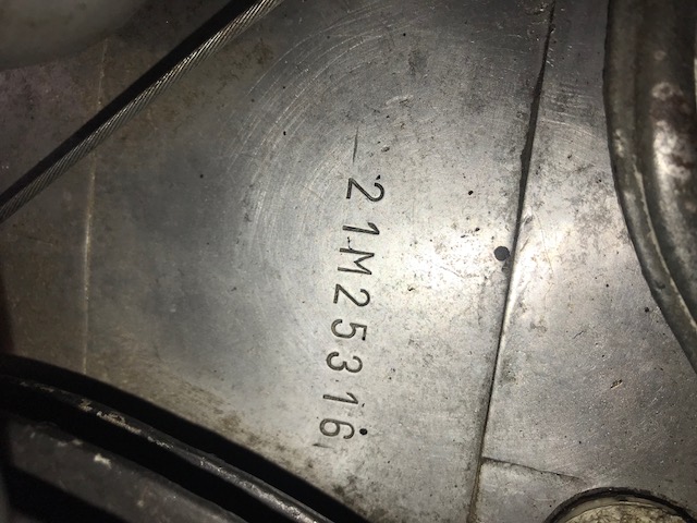

Hi

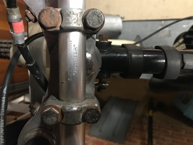

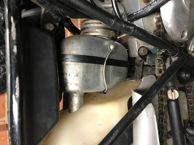

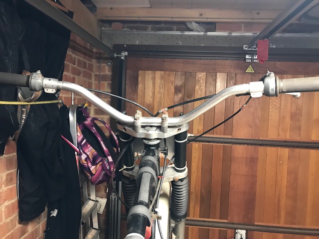

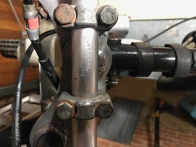

Thanks for the replies, I have found matching numbers so if anyone has a look up that can find my bike i'd appreciate it. The handlebars also look different to what ive seen before so there are pictures of that also, The air box also looks different and I've put a picture up of the throttles on the handlebars and not sure at all why one is there?????
Thanks if you can help.
From the numbers it looks like you have somewhere around '77 model. The number is about 4000 after mine and I know they made 4400 of my model, with the '77 being the next model after. The handlebars are genuine Montesa alloys, maybe original - I don't have experience with later models and there are always little differences. Like I thought the left twist grip is a spare for what-ever reason and this is not normal. The air box looks correct but has a small inlet spout that wasn't used on the earlier models - earlier models had a rubber 90 degrees between the air box and carb so the box sits horizontal - I've seen one other picture with the box mounted like yours. Looks like a nice bike.
Those bars are what came standard on the first (1976) and subsequent Cota 348s. They are 1" in the middle and stepped down to 7/8" for the lever mounts and grips. They have a nice shape but beware of unexpected failure. Mine looked perfect externally but broke unexpectedly in about 2014.
I think you have a rare Cota 247 Tandem/Trail that wore a 348 style tank, if so they apparently came out in July 1978 and started with 21M25307.
I'm only basing this on info I've found on the net, not from personal experience. Refer attached pics. I think yours is the cota 247 Trail as shown bottom left in brochure shot.

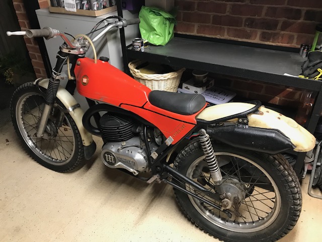

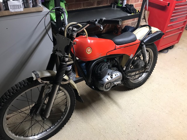

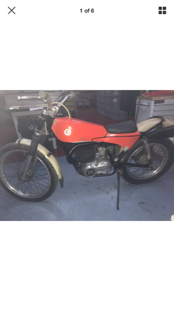

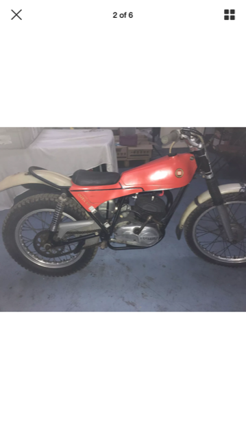

Hi Really appreciate the information you've given me as it will all help on the restoration, I've put some photos of the bike complete to see if anyone can tell me more about it.
Thanks
Gerwan
That is a very nice Cota 247 C, the very last model of 247 made, 1979 or 1980 at best.
