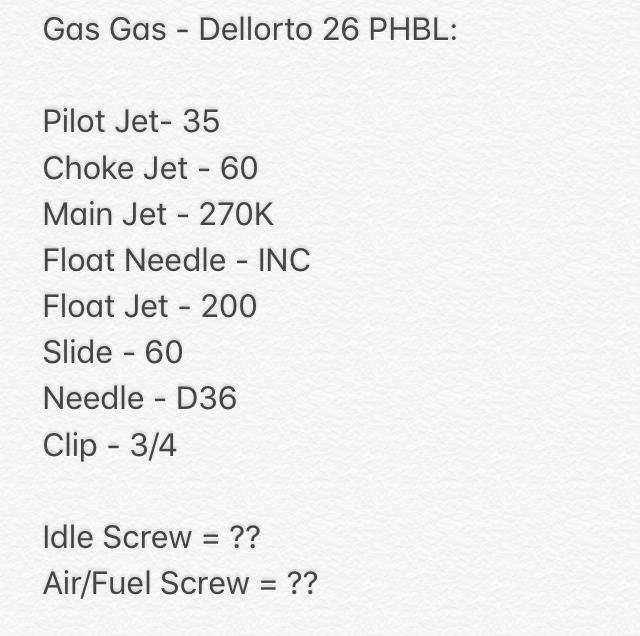

Attached the jetting details from when I stripped the carb last time to clean it....

 You do not show a main jet size. You are showing the nozzle size. Main jet should be like a 125.
It said 270K - I thought that was odd....
The main jet is round, slotted for a flat blade on the end of the nozzle/needle jet depending on which decade you learned carb parts.

Hadn't twigged until I watched the jim snell video on the 26mm Dellorto carb... then GG-UK yesterday told me it was the mixer jet... never knew such beasts existed, just thought it was a quick of the weird little carb on the GG.  Think I was sober when i stripped it the first time.... :wacko::D
