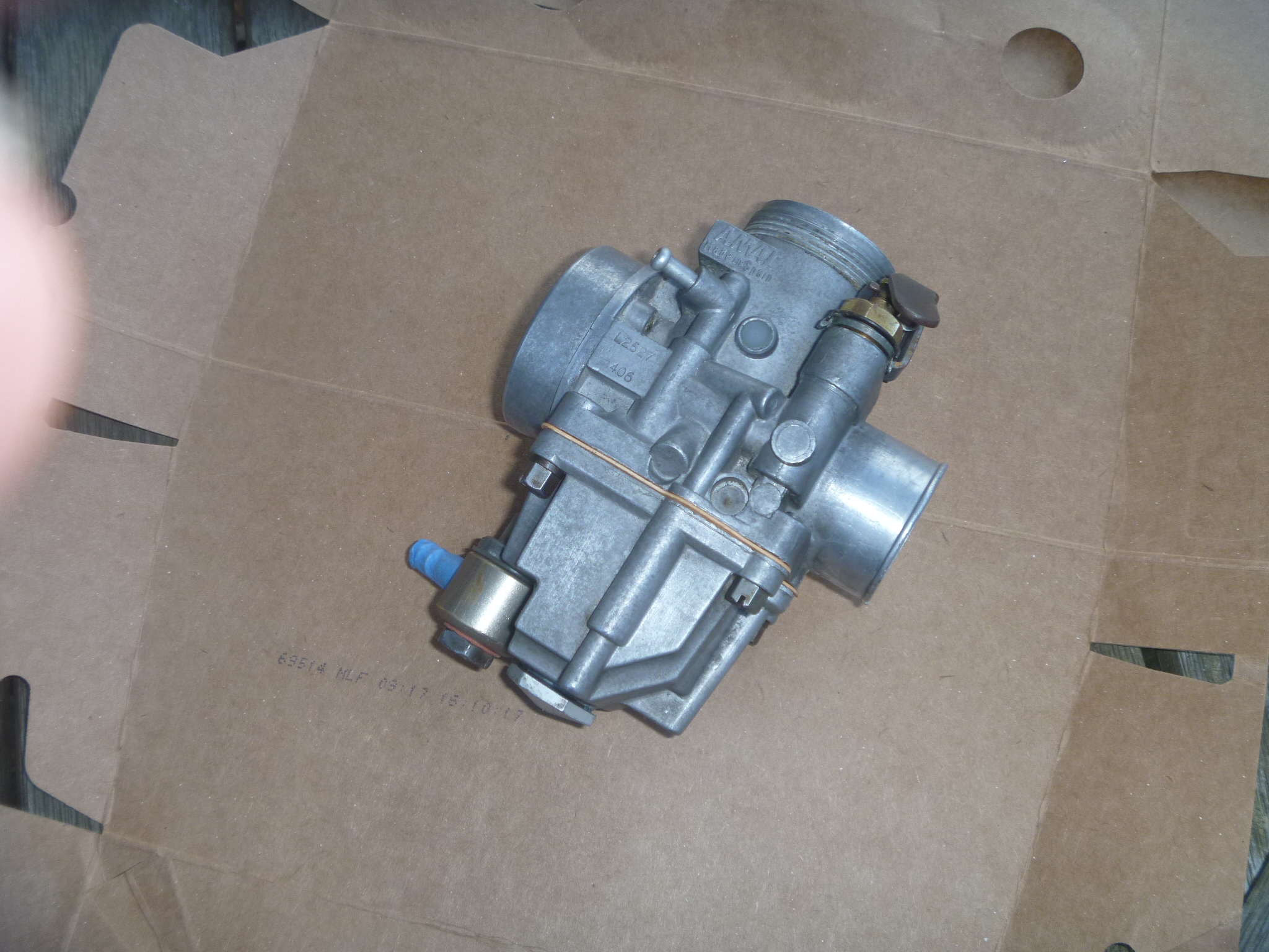

Got carb rebuild kit from local parts supplier and he showed me his huge warehouse of british bike parts and he has trials stuff also there was a TL 200 and a 2 smoke TL which it really liked ,its TLM260r I believe but never had a chance to look closely as he was real busy....I want it.
Carb done and cleaned up ,clear coated the whole thing to prevent corrosion of the alloy and steel fastening.
Did you really clear coat the carb?
Yes ,a decent clean and a good coat over it stops it looking crappy after exterior cleanup,cheers.
