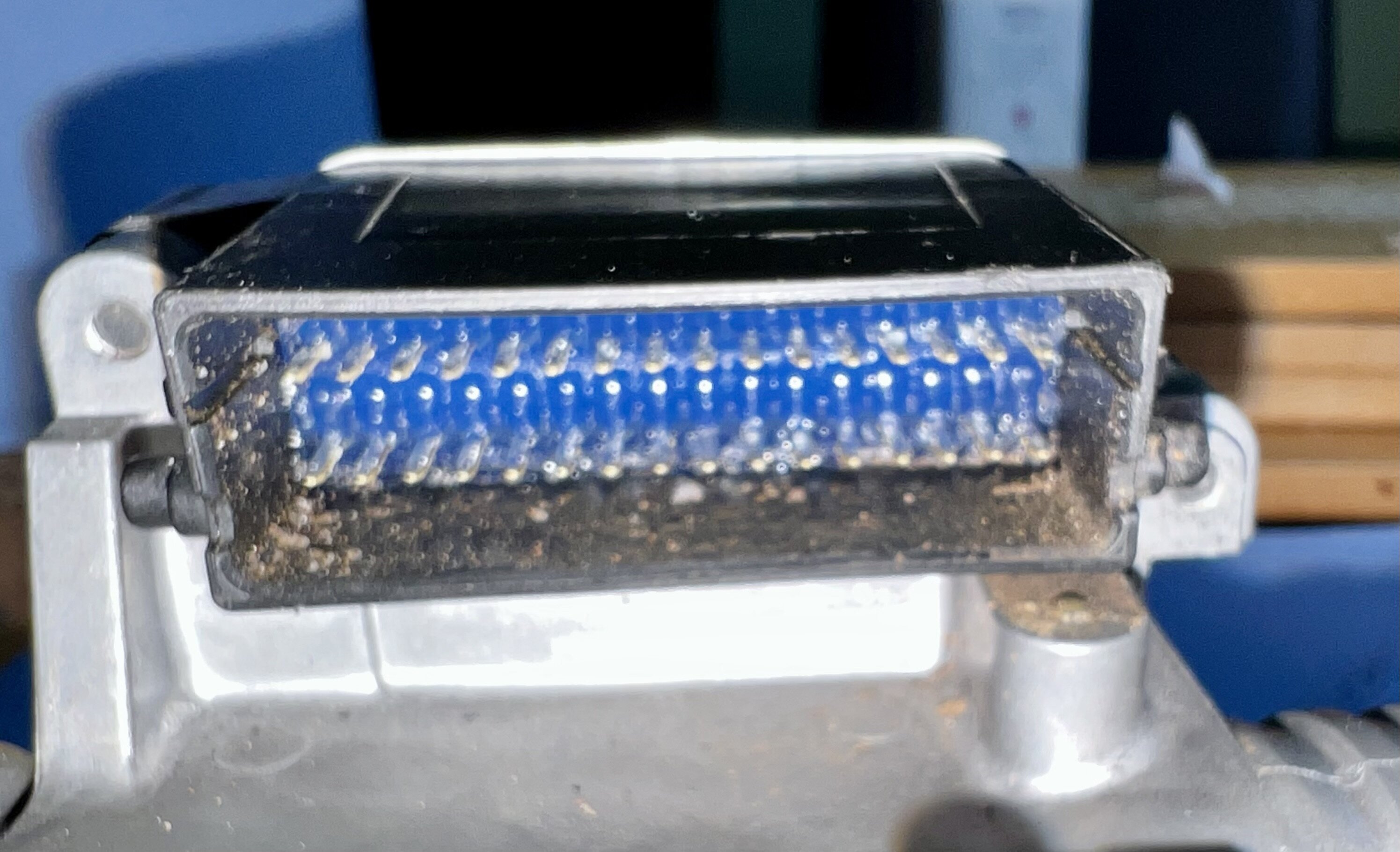

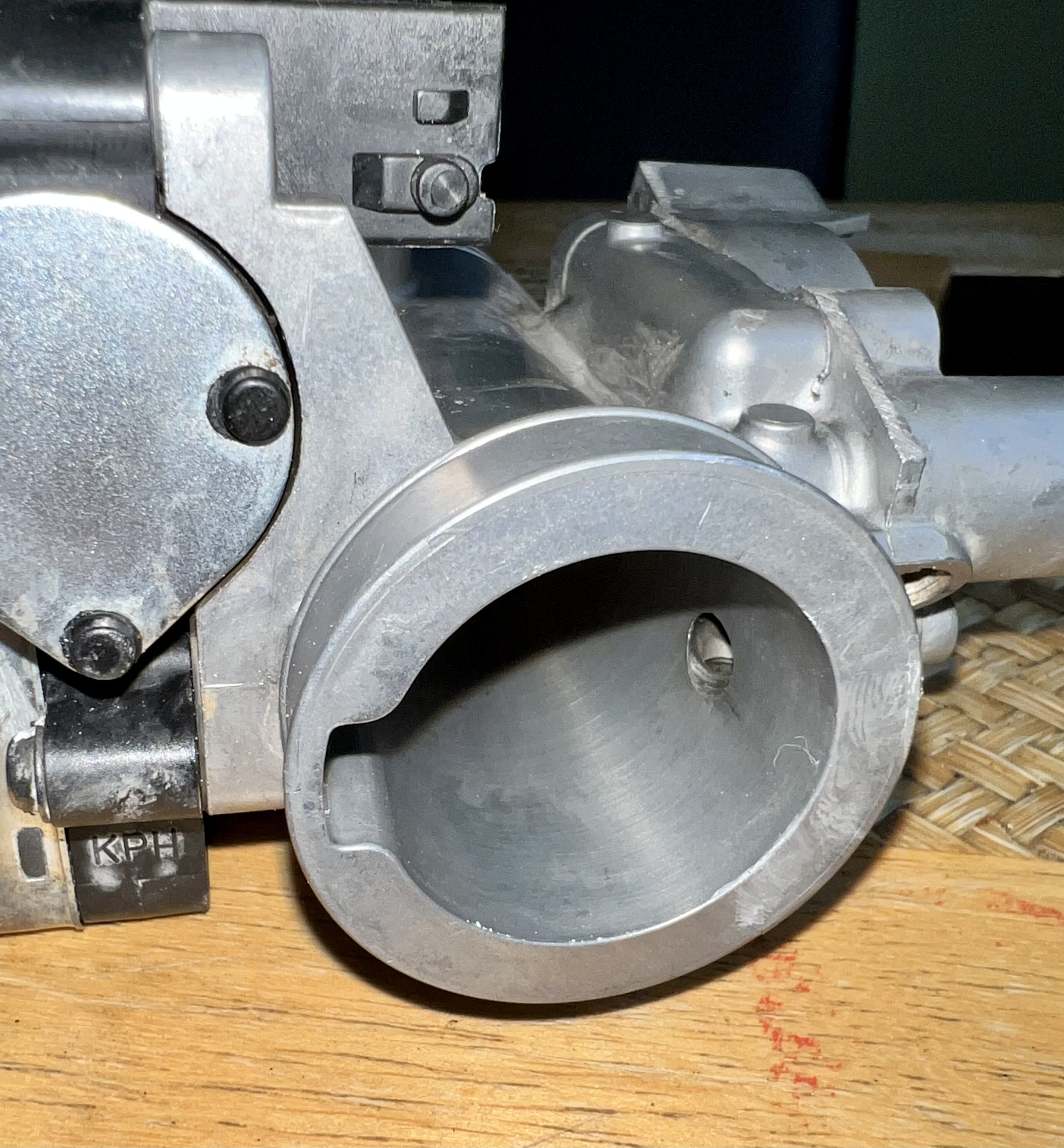

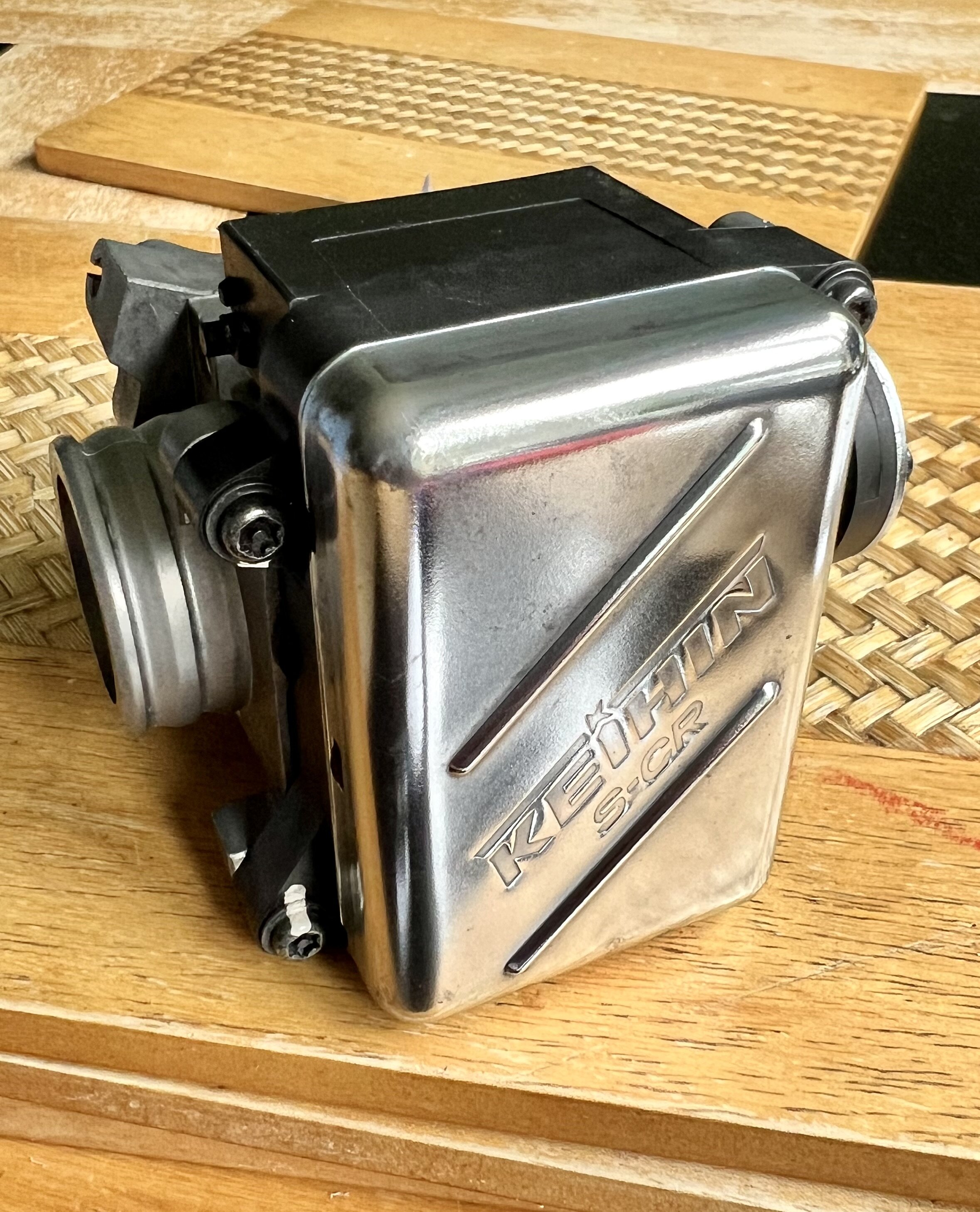

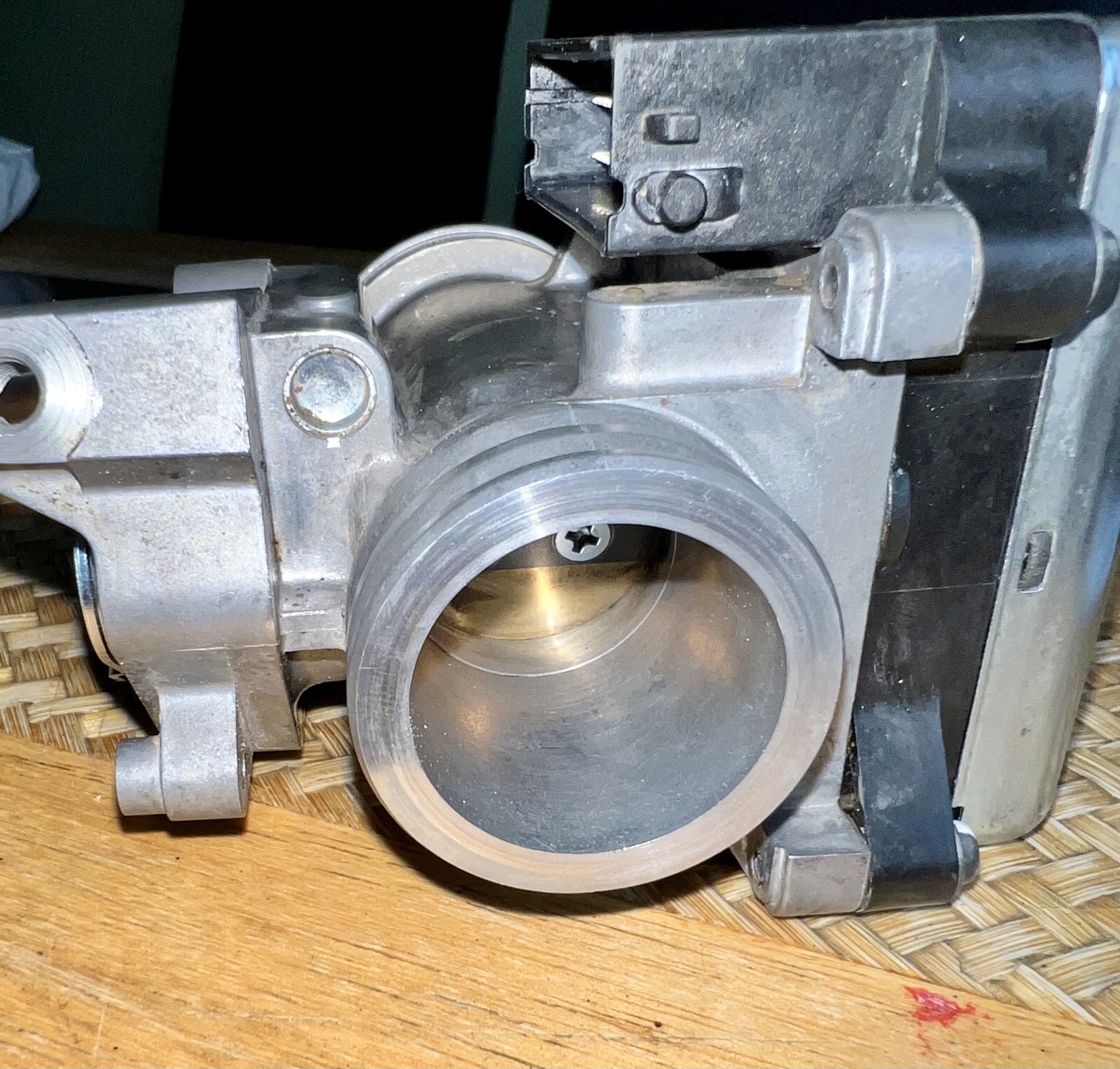

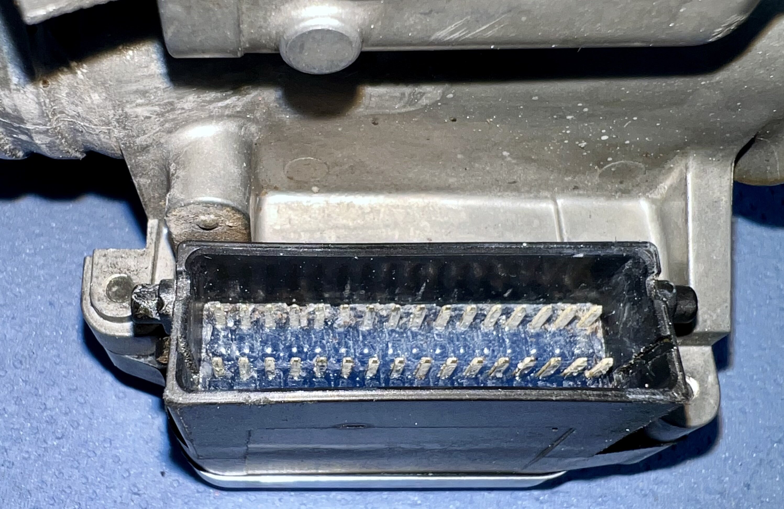

Had the cable throttle body off and gave it a gIMG_5765.thumb.jpeg.0e4534ee6b4d001fb82395a16b1a2c0b.jpegIMG_5766.thumb.jpeg.ddb50f81a4165c8c10fcf228bb1ac296.jpegIMG_5767.thumb.jpeg.154b17414bb430fa7e5d8cfd18af1126.jpegIMG_5759.thumb.jpeg.e4a79e4a9cdfad448b30543cea638280.jpegIMG_5761.thumb.jpeg.a86a8bb4533b091a678ec415e2f251bf.jpegood clean whilst it was off the bike.
