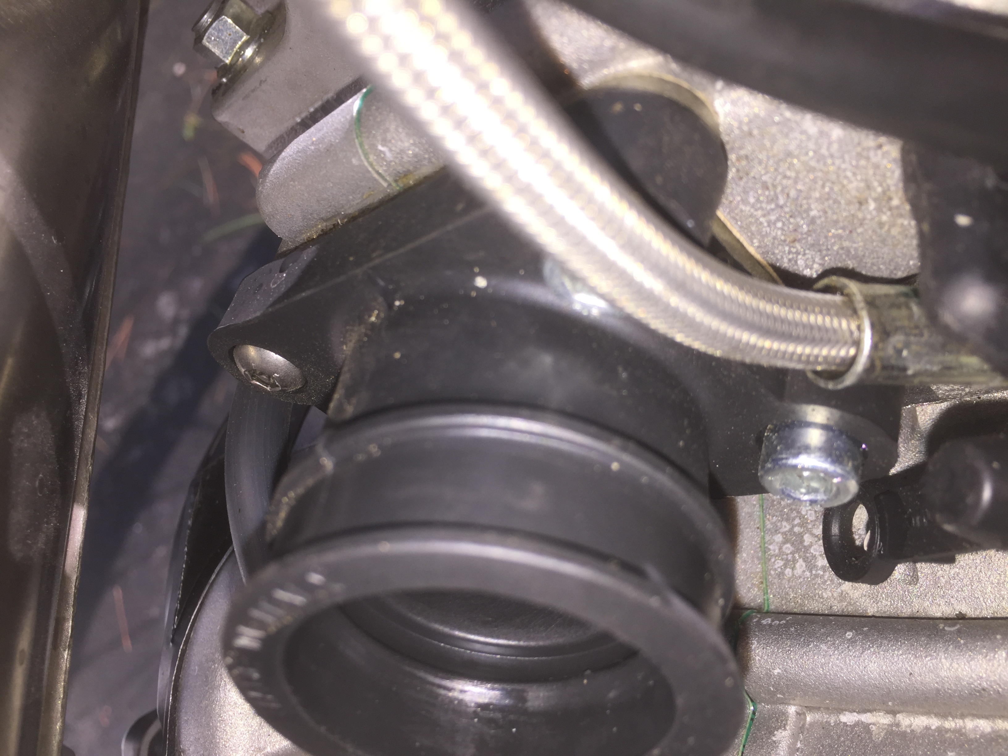

Security screw on intake manifold
Swapped out the reeds for carbon fiber and found one screw on the manifold was a T25 security screw. Wasn’t expecting that.
Also noted was what seems like thread locking compound on idle adjust screw. Explains why it snapped off first time I tried to adjust it. Carb also looks different but not sure. Top of slide housing seems different and bottom of carb has serial number.

It seems those screws are correct. The parts list describes
31.38010.000 x 3. M6x25 Screw t.c.c.e.
and
007.11.031.00.00 x 1. M6x20 Screw (and shows it top left out of the four)
For 125-250-300
Apart from the different heads, one is 5mm shorter??
The 200 just gets 4 x 31.38010.000.
Isn't it that one hole is countersunk, and the other three are flush, for location purposes...?
