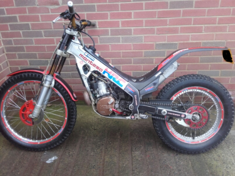

I have a montwas 315r 1999 2 stroke I'm getting a slight rattle/knock when I close the throttle (on run down) there are 4 different size base gaskets 0.3,0.5,0.75,1.0 I currently have a 0.5 on could this be the cause I'm no expert when it comes to 2 strokes any advice welcome
