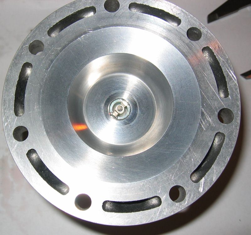

I ran a Clerch cylinder head on the 05 - this had the effect of increasing torque just off idle, better pulling - but less mid range. Initally you think its softer in the mid range but then realise it'll really rev but just needs a little more throttle than before. IMHO brilliant in southern mud but maybe stock better over northern rock steps...
Is this the effect of higher compression or just the different head shape?
Beta sell a head too & it looks similar in shape & cheaper - but I don't know if thats the same profile/volume. Anyone tried that yet?
