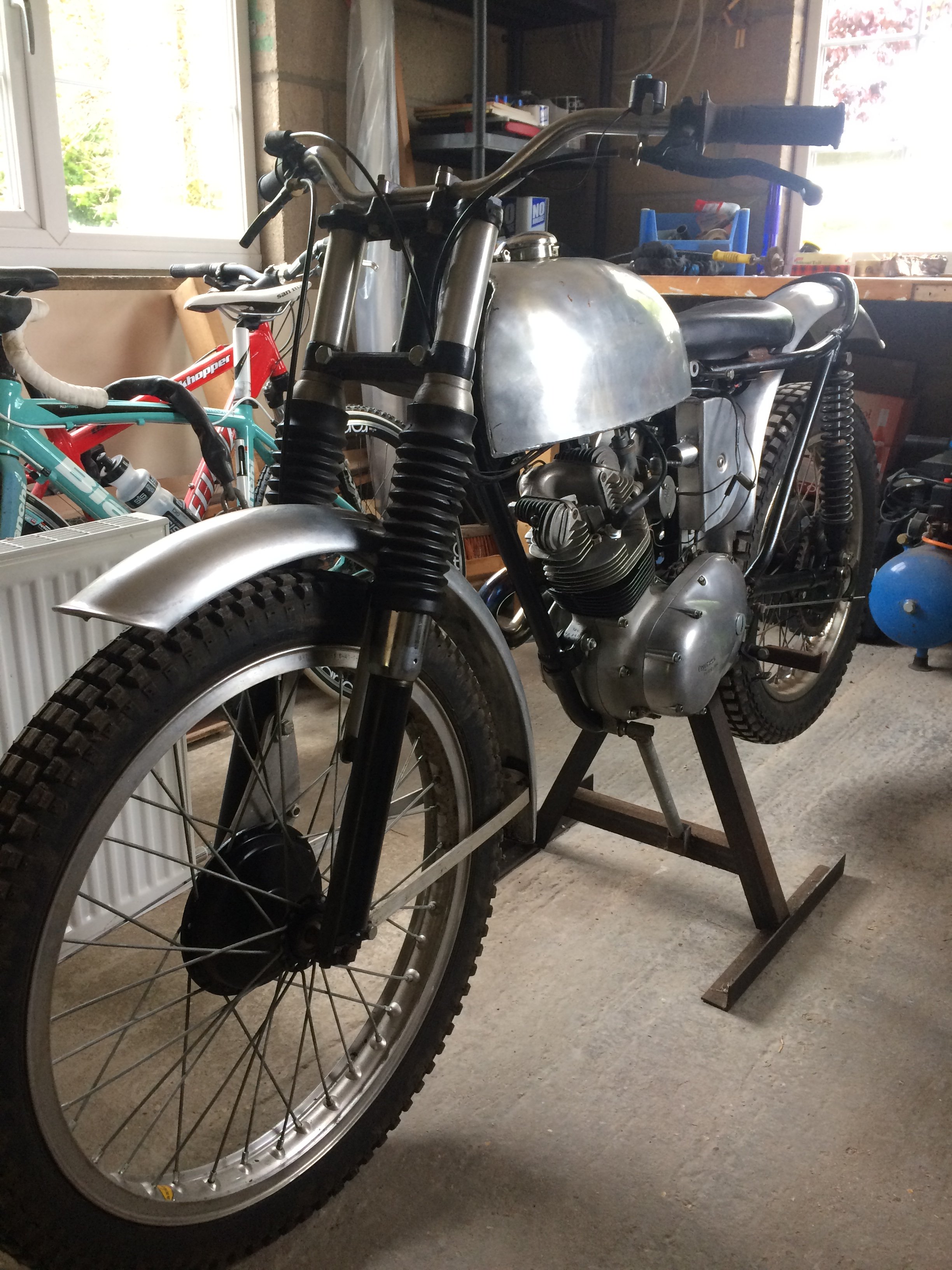

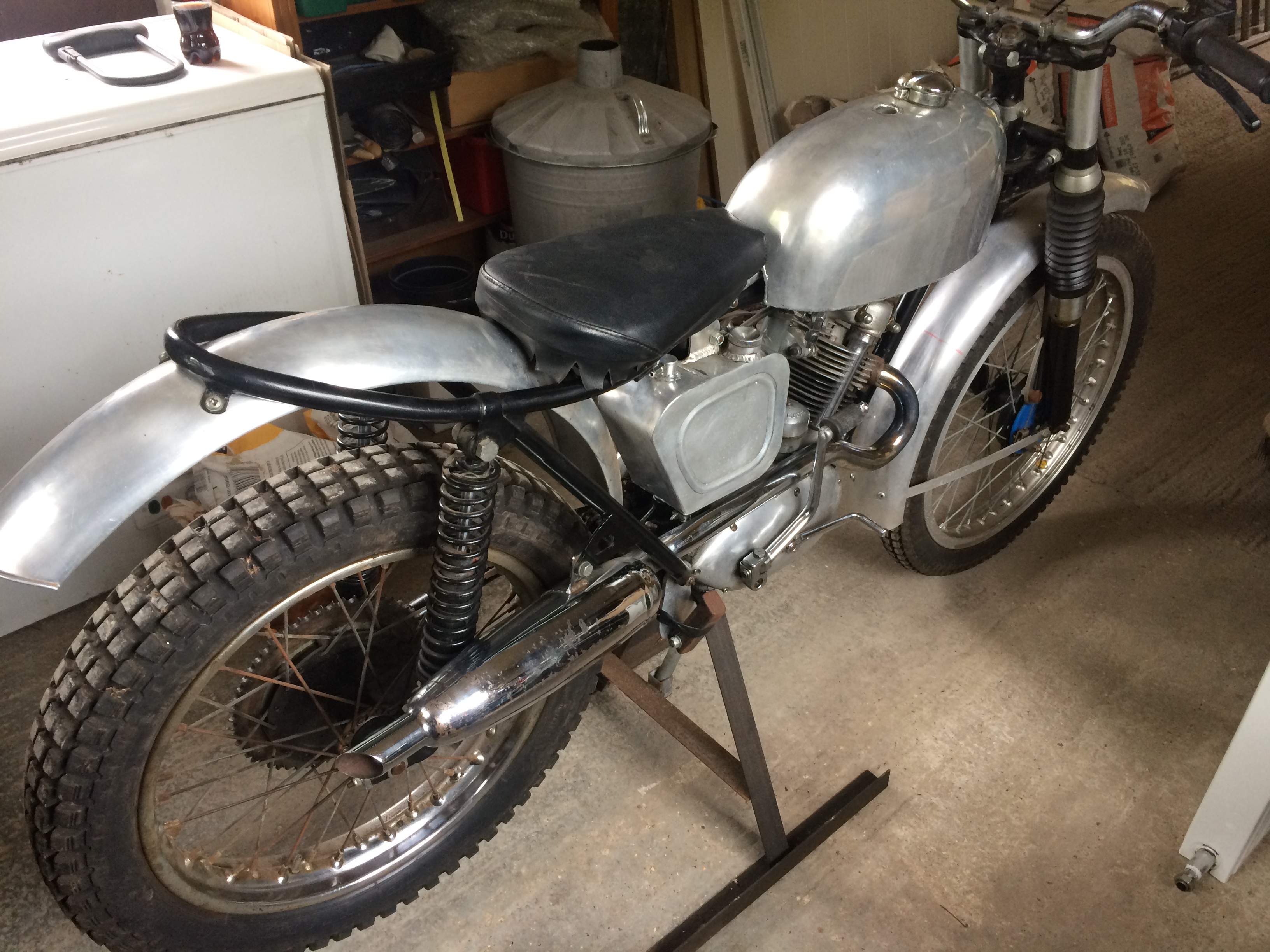

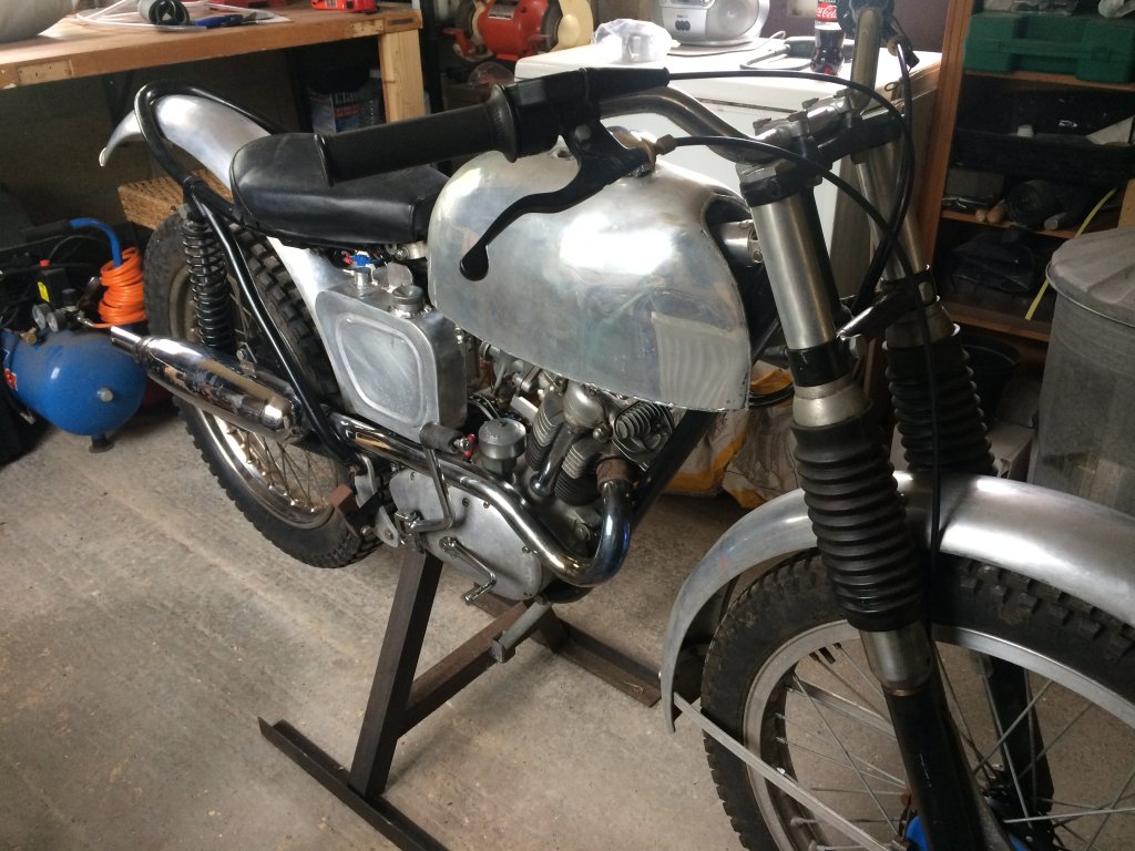

Hello, I'm restoring a 1962 Comerfords Tiger Cub. Has anyone got one of these so I can have some pictures? Just want to try and sort out what it should look like. Also, mine has a 4.00 rear tyre on it that rubs the swinging arm. Would the original bike have a had 3.50 or 3.75 tyre maybe? I know you can get wider rear frames. It if it came with standard width, I'd rather leave it like that. Thanks in advance! Martin.

Yes, it's a genuine Comerfords Cub, I've got the paperwork for it, and the Tiger Cub Club have confirmed that it was supplied to and sold by Comerfords. I'll take a look on the web to see if I can find anymore pics.

Wrong engine for comerfords cub it should be points on side not dizzy engine
Supplied to and sold by Commerfords doesnt make it a Commerfords Cub. If that were the case all the other bikes they were supplied with and sold were Commerfords whatevers. Sorry but looking at the photos thats not what people know as a Commerfords Cub. Thats like saying my James is a Mick Andrews James because hes ridden it

They definitely had 400 x 18 rear tyres that did rub on both their swinging arm and chainguard. Or rather the mud carried by the tyre did! Still a problem with 'upgraded' trials Cubs these days. The alternative is that the engine is moved left putting the rig even more out of centre line balance!

Hi Martin.
The bike you have looks like a Comerfords Cub but it’s not quite right and I’ll check but I think, all of them came from one batch of Mountain Cubs sold to Comerfords in 66.
I know this for two reasons, 1 Gordon Farley told me, they were works replica of the bikes built and used by Gordon and Roy Peplow in 64,65 and 66, in 1962 they were still riding 350’s and 2, I have all the paperwork for mine...
