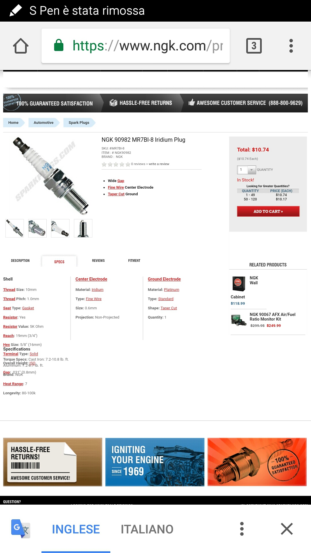

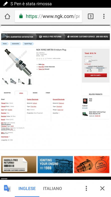

Guys ..... I looked at the spare parts codes of my My2017 and My2018.
..... identical ....
for head and cylinder .... ?
...... only different code that:
of the candle !!! ?
Thats interesting thanks. I can't find the plug code online. Must be unusual. Have you had the plug out and does it look like it has a longer reach or any other major difference?
Boys ..... I .....
actually ... it's ... a candle with iridium electrode technology ...
in fact these candles have two characteristics compared to conventional copper:
thinner electrode and longer isolator ......
? ..... that's why in the descriptive notes Beta 2018 .....
the betas
"commercial man" ....
"they write a new candle with a longer electrode"
but to say only
"new iridium candle"
           NOoooooo ?
Brilliant! Thanks for your help. With the part number 90982 I managed to find it in the UK. As you say Laser Iridium plug. The key to finding it is that the number is MR7B( then the letter i rather than the number 1) -8. Should be able to source one and give it a try now.
