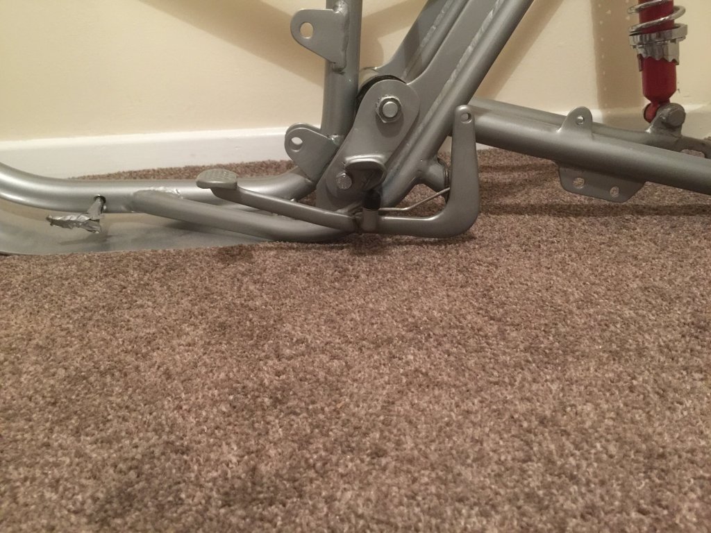

feetupfun Posted May 6, 2018 Share Posted May 6, 2018 Here is I photo I have already showing the brake pedal. The bike in the photo is a very early M49 which shares many components with the M27, including the brake pedal. I will take more photos to show the pedal and mount better, maybe taking the footrest off I don't have any way to show the stand mount because I removed what was left of the broken-off mounting. 1 Quote Link to comment Share on other sites More sharing options...

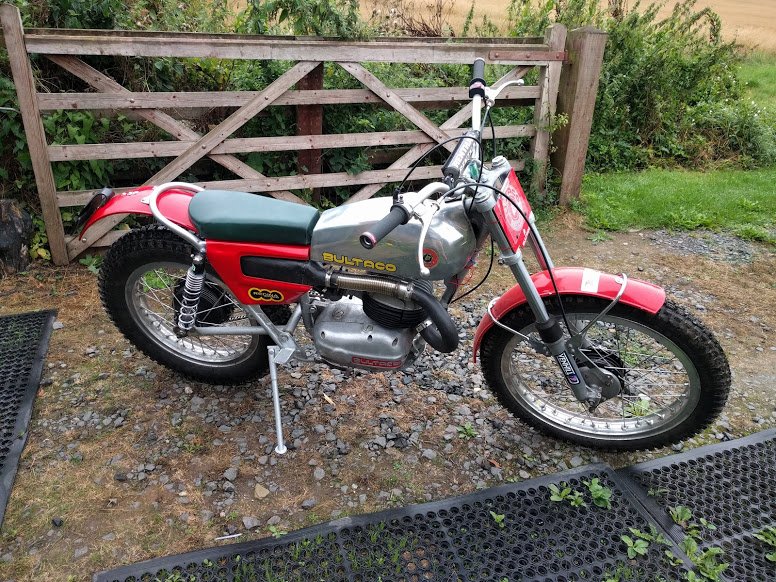

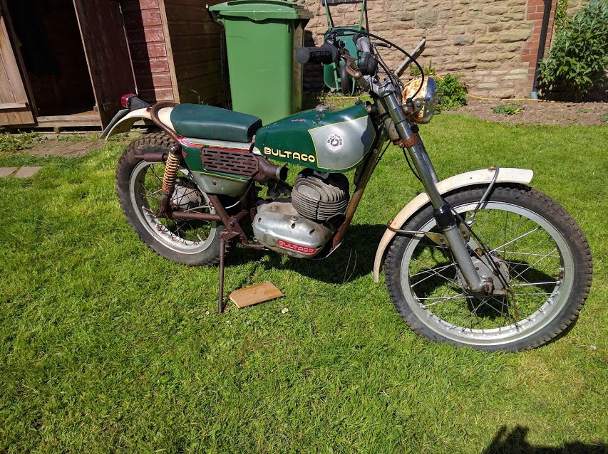

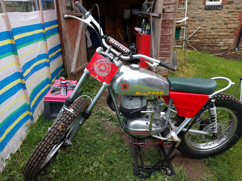

borderbultaco Posted May 29, 2018 Share Posted May 29, 2018 Hi, I too picked up a Sherpa M27 which had stood in an open barn since 1980.. Before and progress to date pics attached. My main problems were the tank - eventually replaced it with a Terry Weedy alloy job - and missing front pipe - I have had to heavily mod a club foot item. Still a bit to do but close to the first firing up (I hope) Good luck with your project and if I can help please get in touch 4 Quote Link to comment Share on other sites More sharing options...

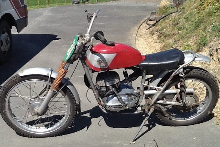

nzpeterb Posted May 31, 2018 Author Share Posted May 31, 2018 Thanks for the photos. It looks like you are nearly there. The alloy tank is an option I hadn't found. The Terry Weedy site has a few interesting parts for old trials bikes. My tank also needs replacement as someone has put something in it that has caused the tunnel to sag so it no longer fits over the frame tube. Then, perhaps because it leaked, they have filled the bottom of the tank with epoxy including the balance tubes and fuel tap. This is one of a number of modifications done by previous owners that defy logic. Another is cutting the outlet bend off the air box and welding it on the right hand side of the air box, then making brackets to run the exhaust outside the frame so it clears the new air box outlet. There is more, but you get the idea. I have purchased a replacement fibreglass tank from Spain but it is now 5 weeks since it was sent so starting to get nervous about whether it has been lost. That is one of the issues with living remote from Europe/UK. I have attached a photo of my bike as purchased. Good luck with your project, and please post again once you are finished. regards, Peter. Quote Link to comment Share on other sites More sharing options...

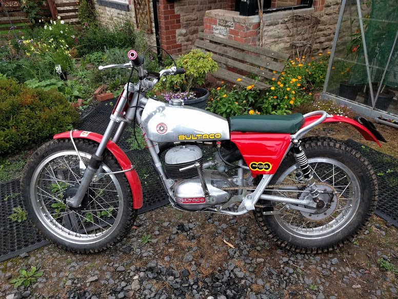

borderbultaco Posted March 29, 2019 Share Posted March 29, 2019 M27 finished. Still of course a work in progress but engine rebuilt, forks, wheels etc rebuilt, starts and runs well. Still stuck for a proper front pipe. Put a bigger gearbox sprocket on for slightly improved road performance. 2 Quote Link to comment Share on other sites More sharing options...

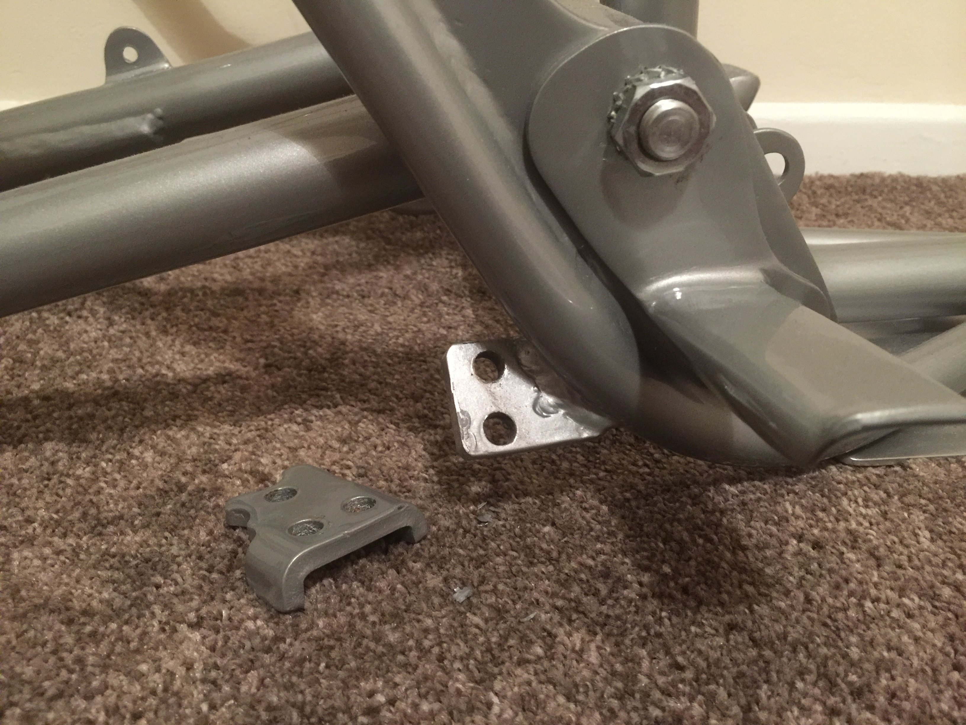

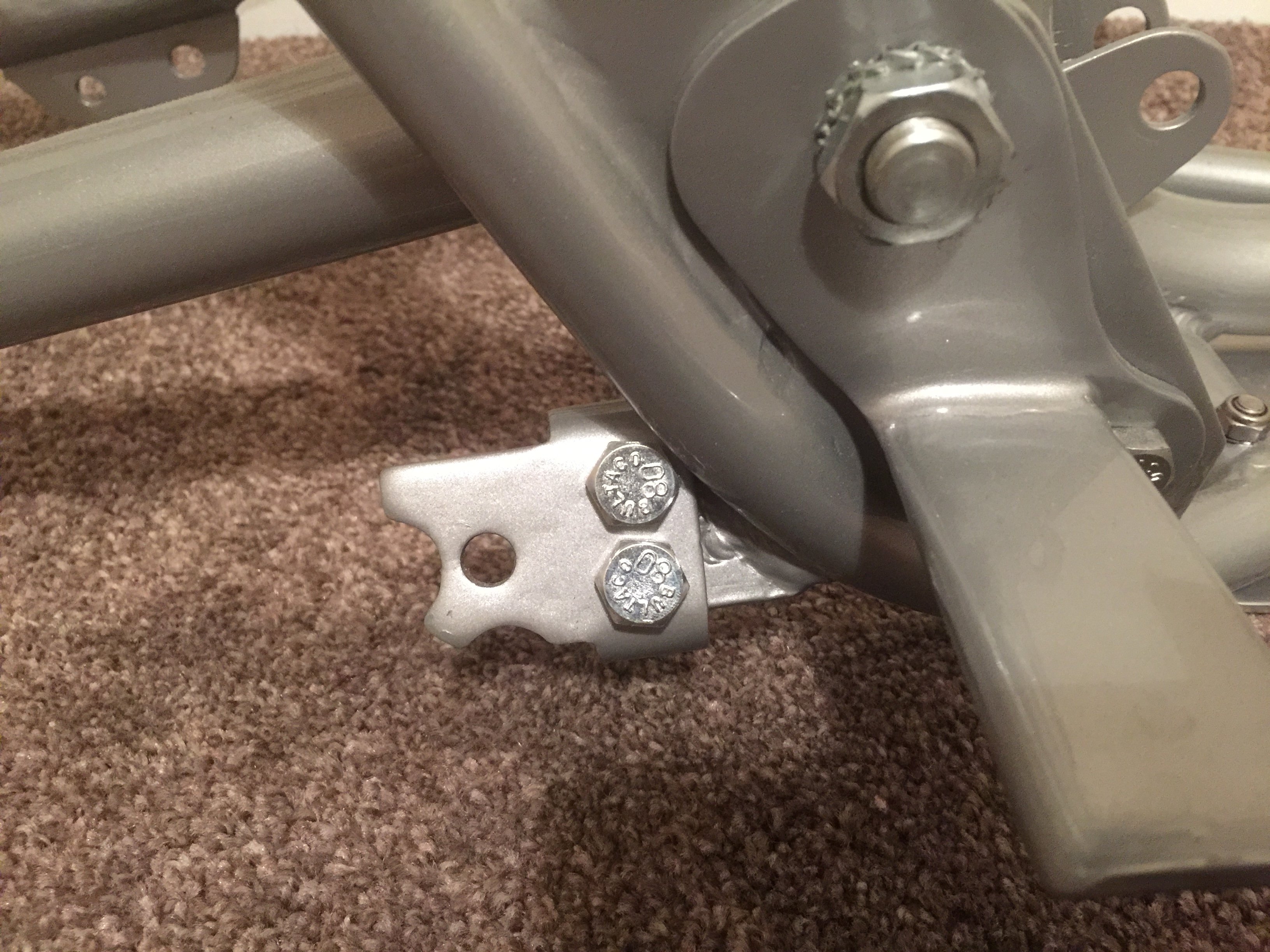

Gary strahan Posted June 21, 2019 Share Posted June 21, 2019 On 5/5/2018 at 10:29 AM, nzpeterb said: Hello all, I have been lucky enough to purchase a 1968 Bultaco Sherpa Model 27. It has not run for 15 years and needs a full rebuild. The previous owners have made some odd modifications such as mounting the stand on the left side and looks like they were going to have the brake and gear change on the right side. At present I am trying to collect the correct parts to put the bike back to original. One item I cannot find is a left side rear brake pedal. I know some new replacements are sold with a serrated pedals like a more modern bike but the original has a solid pad more like the brake on a normal road bike. The length is short being 175 mm (7 inches) from the centre of the pivot pin to the centre of the foot pad. Any leads much appreciated. Regards, Peter. Hi Peter, this is the original rear brake and kickstart mounting brackets.. Hope these help Quote Link to comment Share on other sites More sharing options...
