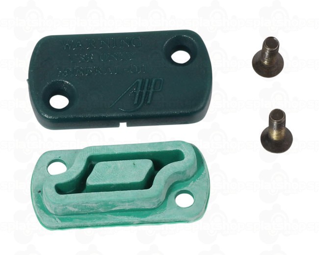

If it has the original AJP M/C cap, it will be green, not black, and say "WARNING Use Mineral oil" on the top.

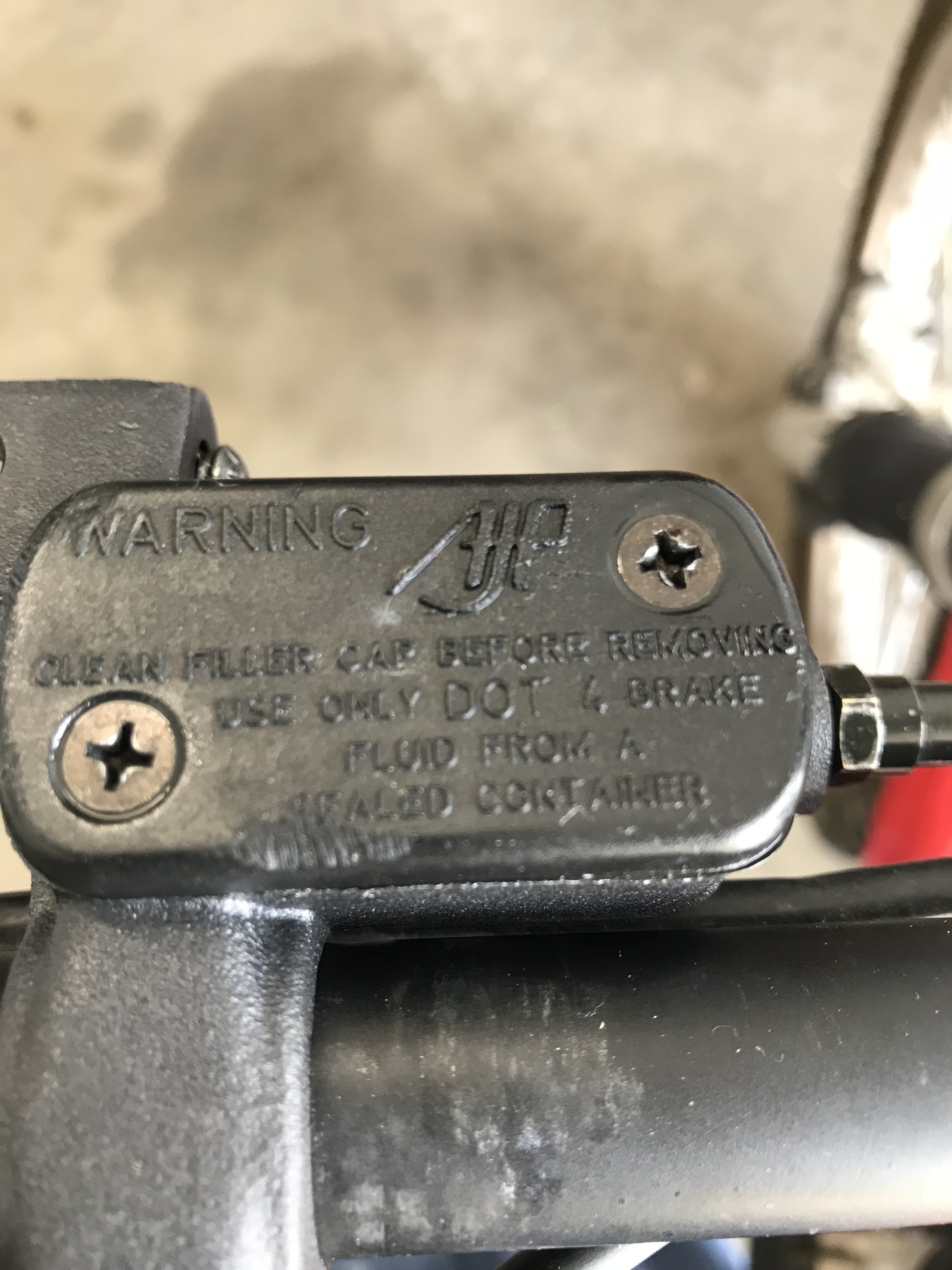

My caps say dot 4 and the rubber is black

A standard 2011 TXT Pro, Racing or RAGA it is a mineral oil system. (and has been that way since 2004) It has had the incorrect Cap and/or Master cylinder put on it at some stage.
Even though the master cylinder pistons look identical, the seal material is different.
