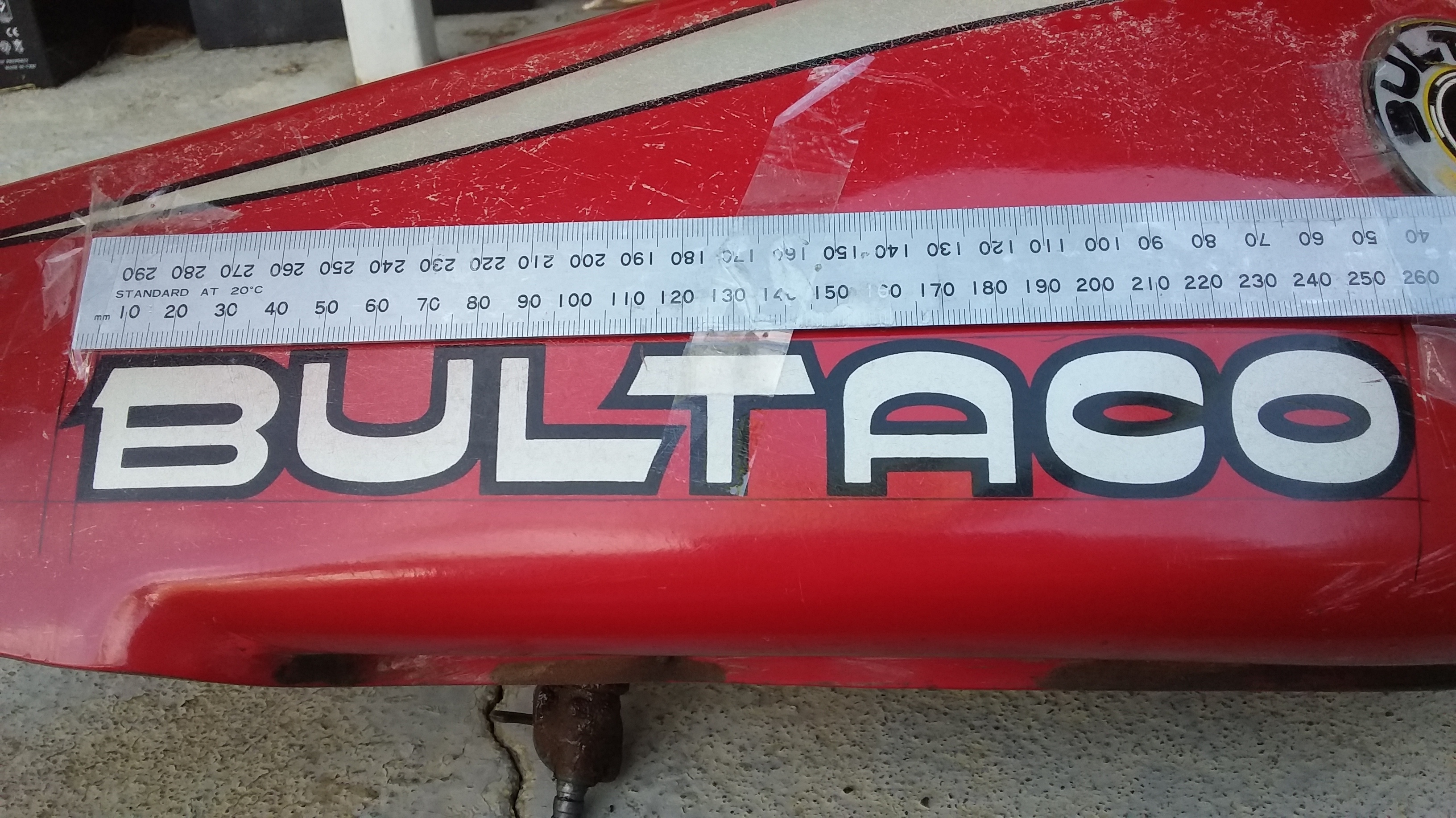

If you bought the stickers in a kit you’ll probably find the the Bultaco tank sticker smaller in height and length than the original, in those kits they are 198/199 size

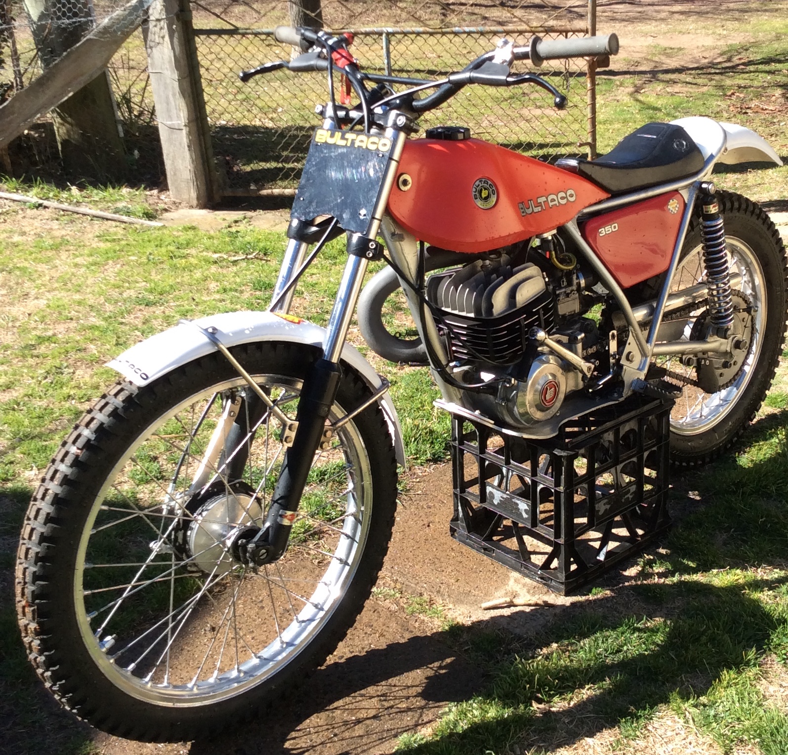

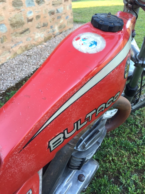

That link is gold, thankyou. I don't remember my 158 having that '75 world champ sticker however, the M183 I bought last year does have it, 182/183 being the next models after 158/159. I'm glad I'm not the only pedantic Trials enthusiast out there, I also noted the "Bultaco" emblems seemed too small on the websites I was viewing compared to what I think it should be, so I got someone in Oz to make them for me. Pics of my 183 below before any restoration.

fourex, what is that sticker between the filer cap and the steering?
Great pics by the way, really useful
That one should be the Made In Spain sticker. My M159 had a World Champion sticker and a European Champion sticker behind the fuel cap on that flat part of the tank and no one seems to sell them. I have the old ones just need to find someone to copy them for me. Can you see where the round Sherpa T stickers go on the airbox. Graham.

Just so I don't confuse things any more then they are already, the pics I've posted showing a weathered tank are of my 183 that I bought Nov 2017. Believing that all the attached stickers were original, I've tried to replicate them and this is the result. Not completely happy as the circular Bultaco emblems are not hard plastic convex items and the word "Bultaco" is a sticker and not a letter only transfer, if you know what I mean.

I put the smaller Bultaco sticker on my 183 and it’s annoyed me ever since

Super helpful Rob at sales@motoresto.com.au in Perth can do the 255mm x 30mm contour cut (not sticker) "Bultaco" for you.
