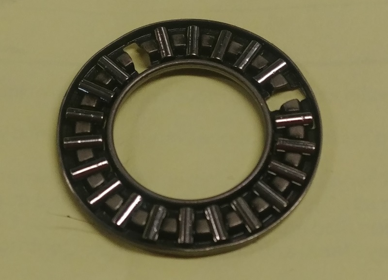

So right there in the parking lot and lay down the bike and take the clutch side case off and what I saw was the clutch need thrust bearing and washer laying at the bottom of the engine. What I think happened is that then I put the case back on, the washer and thrust bearing must have slid down the slave cylinder and fallen off in the engine main cases.  For some reason nothing happened when I fired up the bike after putting it back together, but the next morning all hell broke loose.
Here is what the thrust needle bearing looked like (not bad, just a couple of needles dropped off):

I found one of the needle stuck to the magnetic fill up plug 1/4 chewed, and a bunch of metal "dust" on the clutch assembly.  I flushed the whole engine several time with gas and didn't see anything else coming out.

Probably not a good move to change to DOT 5.1 for the clutch as the system uses mineral oil for the hydraulic fluid, I don't believe DOT 5.1 is compatible and would swell the master cylinder seals. The slave cylinder O rings are teflon coated so would just need a clean. Best to use a dab of tacky grease on the slave piston to hold the thrust bearing and washer in place when re-assembling. There is usually a fair amount of swarf behind the clutch belleville washer (spring) so I wouldn't take it for granted that the other needle roller has been minced. Have an even closer look at the kickstart idler gear and clutch ring gear, it doesn't take much at all to damage one of the gear teeth and make a clunking noise, though if not too bad, you can use slip stones to ease back the damage. Would pay to strip the motor and look for the lost needle, then at the same time replace all of the primary and secondary shaft bearings while stripped out, they don't cost much. Definitely replace the 2 sets of 1/2 needle rollers as these wear quickly and can cause more problems. Only real special tool you'd need is a flywheel puller. Bye, Peter B.
sounds as though the other roller got between the primary gears and damaged them.
